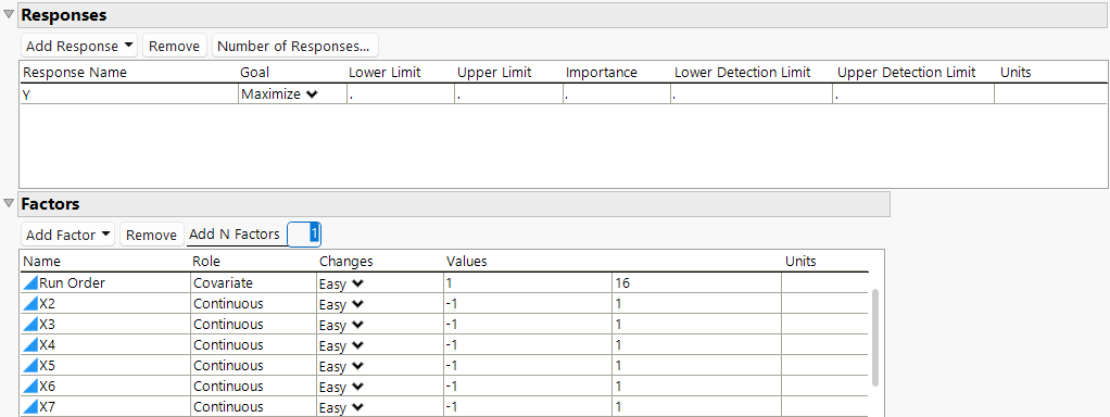

8. Click Add Factor > Covariate.
9. Select Run Order and click OK.
10. Type 7 next to Add N Factors.
11. Click Add Factor > Continuous.
Figure 5.64 Responses and Factors
12. Click Continue.
