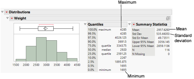

Use a histogram of Weight to answer these questions.
Create the Histogram
1. Select Help > Sample Data Folder and open Car Physical Data.jmp.
2. Select Analyze > Distribution.
3. Select Weight and click Y, Columns.
4. Click OK.
5. To rotate the report window, click the Weight red triangle and select Display Options > Horizontal Layout.
Figure 5.7 Distribution of Weight
The report window contains three sections:
A histogram and a box plot to visualize the data
A Quantiles report that shows the percentiles of the distribution
A Summary Statistics report that shows the mean, standard deviation, and other statistics
Interpret the Distribution Results
Using the results presented in Figure 5.7, the planning specialist can answer the questions.
What is the average car weight?
The Histogram shows an approximate weight of 3,000 lb. The Summary Statistics show an approximate mean weight of 2,958 lb.
How spread out are the weights (standard deviation)?
The Summary Statistics show a standard deviation of approximately 536 lb.
What are the minimum and maximum weights?
The Histogram shows anapproximate minimum weight of 1,500 lb and an approximate maximum weight of 4,500 lb. The Quantiles show a minimum weight of 1,695 lb and a maximum weight of 4,285 lb.
Are there any outliers?
No.

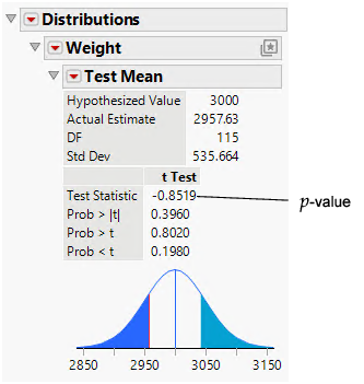

Based on other research, the railroad company has determined that an average weight of 3,000 lb is the most efficient to transport. Now, the planning specialist needs to find out whether the average car weight in the general population of cars that they might transport is 3,000 lb. Use a t test to draw inferences about the broader population based on this sample of the population.
Test Conclusions
1. Click the Weight red triangle and select Test Mean.
2. In the window that appears, type 3000 in the Specify Hypothesized Mean box.
3. Click OK.
Figure 5.8 Test Mean Results
Test Mean Results
Interpret the t Test
The primary result of a t test is the p-value. In this example, the p-value is 0.396, and the analyst is using a significance level of 0.05. Because 0.396 is greater than 0.05, you cannot conclude that the average weight of car models in the broader population is significantly different from 3,000 lb. Had the p-value been lower than the significance level, the planning specialist would have concluded that the average car weight in the broader population is significantly different from 3,000 lb.
