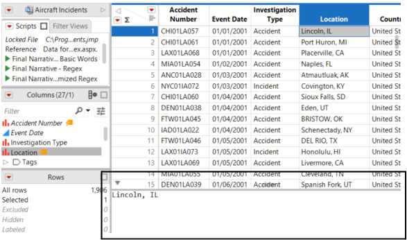

The Data Grid Edit Pane
The Data Grid Edit pane lets you edit any cell’s value in a dedicated panel, making it easier to work with all types of data. Use the Data Grid Edit pane to isolate a cell’s value to modify it without interfering with other cells in the data table.
Click the Open Edit Pane button Image shown here in the lower left corner of a data table to open the Data Grid Edit pane.
Figure 4.22 The Opened Data Grid Edit Pane

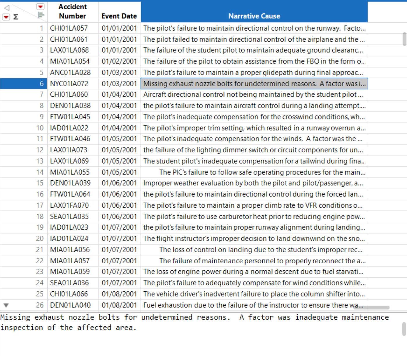

Example of Editing a Long Text Value with the Data Grid Edit Pane
In this example, the data table has a column of narratives describing aircraft incidents that were reported to the National Transportation Safety Board. Cells with long text values like these narratives can be difficult to edit within a data table, so you use the Data Grid Edit pane to edit the text values more easily.
1. Select Help > Sample Data Folder and open Aircraft Incidents.jmp.
2. Scroll to the right-most side of the data table.
3. Select cell 6 of the column Narrative Cause.
4. Click the Open Edit Pane button in the lower left corner of the data table.
The Data Grid Edit Pane opens.
Figure 4.23 Displaying a Long Text Value in the Data Grid Edit Pane
5. In the Data Grid Edit Pane, delete the word “maintenance” from the text value.
6. Select any area back within the data table.
7. To confirm the change, select cell 6 of the column Narrative Cause again.
