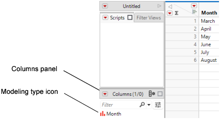

6. Enter the Month information by clicking in a cell and typing.
Figure 3.4 Month Column Completed
In the columns panel, look at the modeling type icon to the left side of the column name. It has changed to reflect that Month is now nominal (previously it was continuous). Compare the modeling type shown for Column 1 in Figure 3.3 and for Month in Figure 3.4. This difference is important and is discussed in View or Change Column Information in a Data Table.

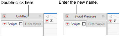

Change the Data Table Name
1. Double-click the data table name (Untitled) in the Table Panel.
2. Type the new name (Blood Pressure).
