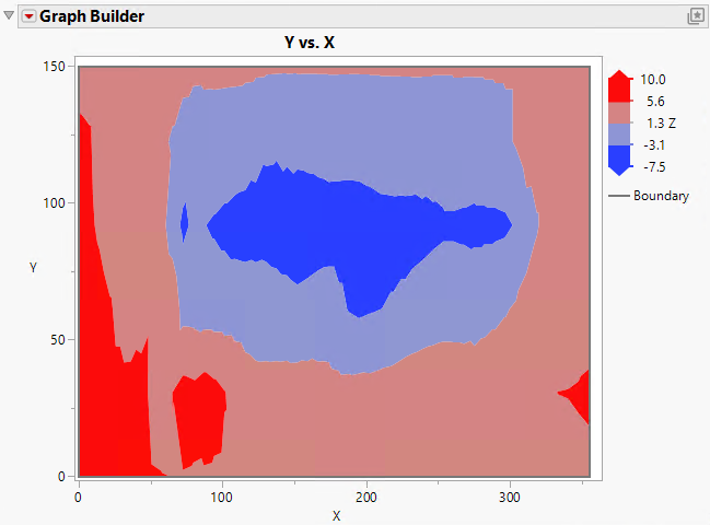

You can create the same contour plot that is shown in Figure 10.2 by using Graph Builder.
1. Select Help > Sample Data Folder and open Little Pond.jmp.
3. Click and drag the X coordinate to the X zone.
4. Click and drag the Y coordinate to the Y zone.
5. Click and drag depth, Z, to the Color zone.
6. Click the Contour element Image shown here.
Figure 10.3 Contour Plot in Graph BuilderĀ
Notice the plot that is produced from the Contour platform looks slightly different from the plot that is produced by using Graph Builder.
