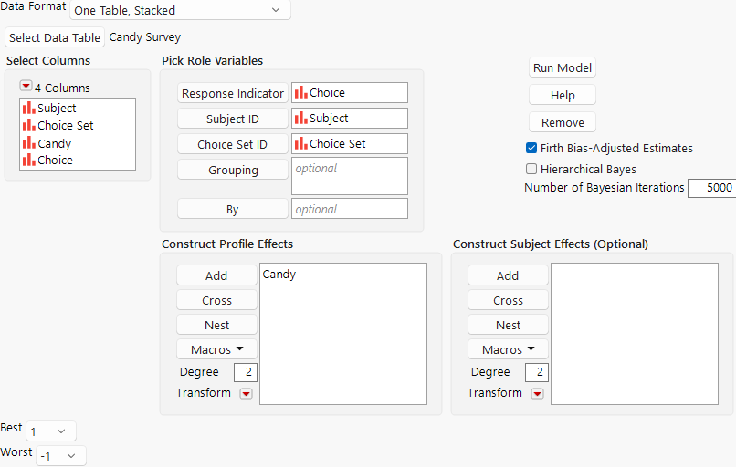

4. Assign column roles:
Select Choice and click Response Indicator.
Select Subject and click Subject ID.
Select Choice Set and click Choice Set ID.
Select Candy and click Add in the Construct Profile Effects panel.
Figure 19.3 Completed MaxDiff Analysis Launch Window
Because you designated the Best choice as 1 and the Worst choice as -1, you make no change to the Best and Worst choice indicators at the bottom left of the launch window.

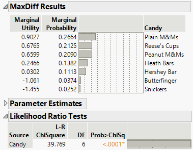

5. Click Run Model.
Figure 19.4 MaxDiff Report
MaxDiff Report
The report indicates that Candy is significant. The three candy types with the highest utilities are Plain M&Ms, Reese’s Cups, and Peanut M&Ms.

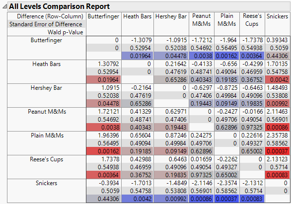

6. Click the MaxDiff Model red triangle and select All Levels Comparison Report.
Figure 19.5 All Levels Comparison Report for Candy Types
The comparison report indicates which pairs of candy types differ significantly in terms of utility. The third entry in each cell is the p-value for the difference defined by the row item’s utility minus the column item’s utility. The intensity of the color for the p-value indicates how significant a difference is. The shading, blue or red, indicates whether the difference (row - column) is negative or positive. The p-values are not adjusted to control the multiple comparison error rate and should be used only as a guide. For more information about the All Level Comparisons Report, see “MaxDiff” in Consumer Research.
