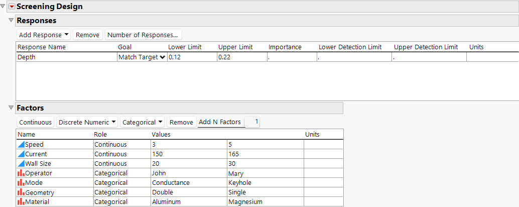

Specify the Response
1. Select DOE > Classical > Factor Screening > Screening Design.
2. In the Responses panel, double-click Y under Response Name and type Depth.
Note that the default Goal is Maximize. Your goal is to find factor settings that enable you to obtain a target depth of 0.17 inches with limits of 0.12 and 0.22.
3. Click the default Goal of Maximize and change it to Match Target.
4. Click under Lower Limit and type 0.12.
5. Click under Upper Limit and type 0.22.
6. Leave the area under Importance blank.
Because there is only one response, that response is given Importance 1 by default.
The completed Responses section appears in Figure 10.2. Now, specify the factors.
Specify Factors
Type 3 in the Add N Factors box and click Continuous.
7. Double-click X1 and type Speed.
8. Use the Tab key to move through the rest of the values and factors. Make the following changes:
a. Change the Speed values to 3 and 5.
b. Change X2 to Current, with values of 150 and 165.
c. Change X3 to Wall Size, with values of 20 and 30.
9. Type 4 in the Add N Factors box and select Categorical > 2 Level.
10. Double-click X4 and type Operator.
11. Use the Tab key to move through the rest of the values and factors. Make the following changes:
a. Change the Operator values to John and Mary.
b. Change X5 to Mode, with values of Conductance and Keyhole.
c. Change X6 to Geometry, with values of Double and Single.
d. Change X7 to Material, with values of Aluminum and Magnesium.
Figure 10.2 Responses and Factors for Weld Experiment
Note: To enter the factors automatically, select Help > Sample Data Folder and open Design Experiment/Weld Factors.jmp. Click the Screening Design red triangle and select Load Factors.

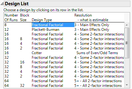

3. Accept the default selection to Choose from a list of fractional factorial designs and click Continue.
4. Select the first Fractional Factorial design.
Figure 10.3 Design List for Three Continuous Factors and Four Categorical Factors
This specifies an eight-run Resolution 3 fractional factorial design. For information about resolution, see Resolution in Screening Designs.

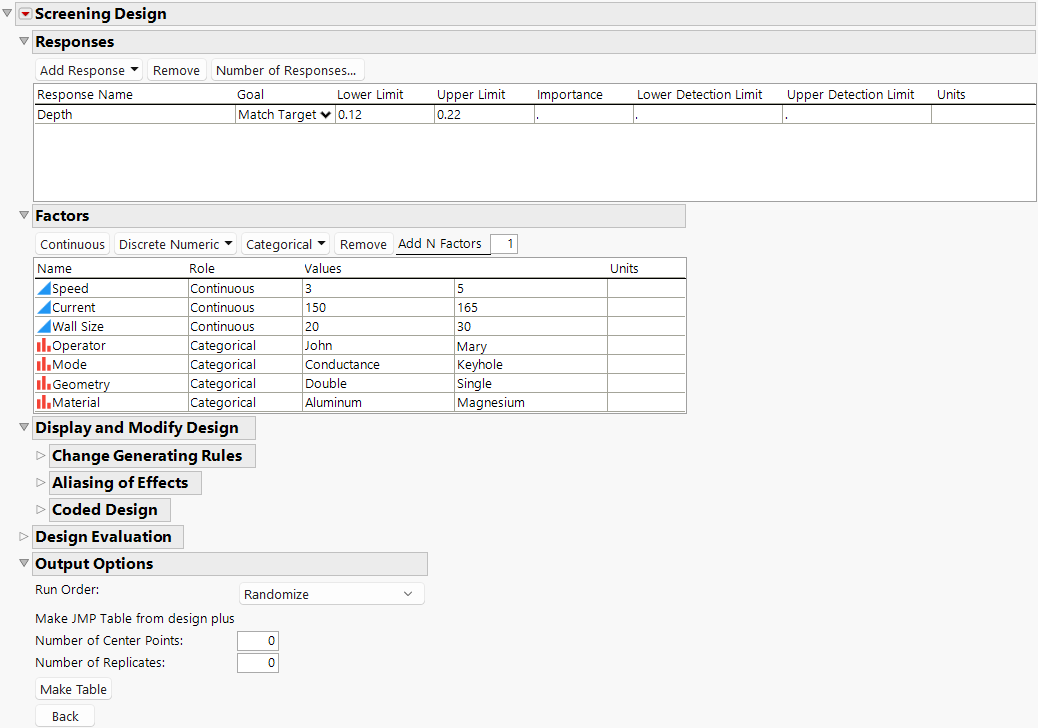

In the Output Options section, note that Run Order is set to Randomize. This means that the design runs appear in random order in the design table. This is the order you should use to conduct your experimental runs.
Figure 10.4 Completed Screening Design Window
6. Open the Aliasing of Effects section under Display and Modify Design.
Figure 10.5 Aliasing for an Eight-Run Fractional Factorial Design
Recall that you selected a Resolution 3 design (Figure 10.3). In a Resolution 3 design, some main effects are confounded with two-way interactions. The Aliasing of Effects section indicates that, for this Resolution 3 design, every main effect is completely confounded with three two-way interactions. If you suspect that two-way interactions are active, this is a poor design. For a description of confounding, see Two-Level Regular Fractional Factorial.

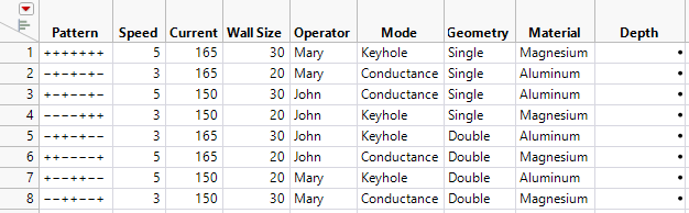

7. Click Make Table.
Figure 10.6 The Design Data Table
Notice the following properties of the design table:
The table uses the names for the responses, factors, and levels that you specified.
The Pattern column shows the assignment of high and low settings for the design runs.
This fractional factorial design is a Resolution 3 design. It enables you to study the main effects of seven factors in eight runs.

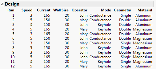

Under Number of Runs, the selected option is Default with the number of runs set to 12. Keep this setting.
8. Click Make Design.
Figure 10.7 Main Effects Screening Design

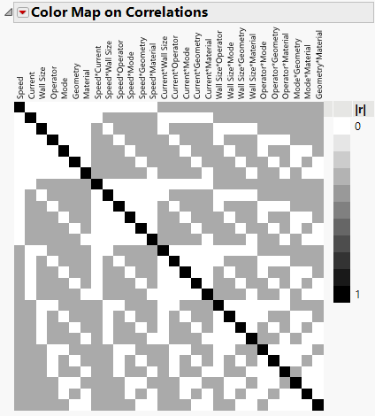

9. Open the Design Evaluation section and then open the Color Map on Correlations section.
Figure 10.8 Color Map on Correlations for 12-Run Main Effects Screening Design
The Color Map on Correlations shows that the main effects are uncorrelated with each other. This is indicated by the white off-diagonal cells in the upper left corner of the color map. Each main effect is partially aliased with some two-way interactions, indicated by the gray cells. Hover over one of the gray cells to see that the absolute correlations are 0.333.
