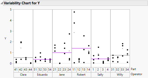

2. In the data table, click the green arrow next to Variability Chart - Nested table script.
3. Click the Variability Gauge Analysis for Y red triangle, deselect Show Range Bars, and select Show Group Means.
Figure 4.36 Variability Chart for Y
The variability chart shows the three measurements by each Operator on each of four parts. Horizontal lines show the mean measurement for each Operator.
