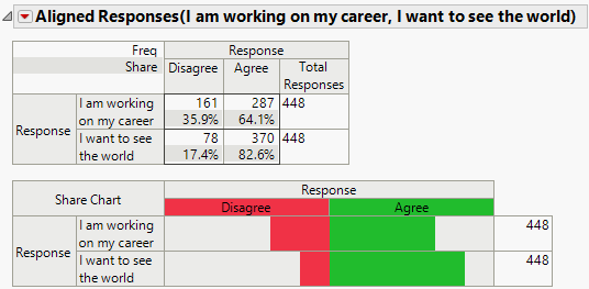

Figure 3.31 Aligned Response Report
Notice that the Share Chart is a directional bar chart. The type of bar chart you see depends on the modeling type of the columns.
Ordinal columns result in a directional bar chart. The columns in this example are both ordinal.
Nominal columns result in a stacked bar chart.
