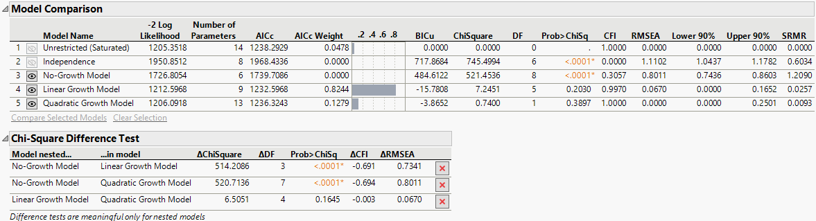

Figure 8.13 Model Comparison and Chi-Square Difference Test ReportsĀ
The Model Comparison report in Figure 8.13 contains fit indices for five models: the Unrestricted (Saturated), the Independence, the No-Growth, the Linear Growth, and the Quadratic Growth models. Overall, the Linear Growth model is the most supported model compared to other models. This conclusion is based on the largest AICc Weight value (0.824) and very good fit indices (CFI = 0.997, RMSEA = 0.067). The Quadratic Growth model also fits the data well, with perfect fit indices (CFI = 1 and RMSEA = 0), but it is less favored based on the AICc Weight. The Independence and No-Growth models show poor fits, with high ChiSquare values and inadequate fit indices, which indicate that they do not represent the data well.
Note: It is important to select the appropriate independence model when comparing growth models. The No-Growth model is typically recommended as the independence model because it serves as a meaningful baseline to evaluate the fit of other growth trajectories. However, you can choose any other trajectory as the independence model. To do this, select a row in the Model Comparison report, right-click, and select the Set as Independence Model option. To revert to the default independence model, right-click on the selected model and choose the Reset Default Independence Model option.
The Chi-Square Difference Test report shown in Figure 8.13 also compares the fit of these models. The comparisons are made by looking at changes in the chi-square statistic, CFI, and RMSEA between the nested models. Overall, it can be concluded from this report that the No-Growth model fits significantly worse than both the Linear and Quadratic Growth models. There is not a significant difference between the fit of the Linear and Quadratic Growth models, which suggests that adding a quadratic term does not significantly improve the model fit over the linear model. Although the Quadratic Growth model fits the data very well, its marginal improvement in fit does not justify the added complexity over the Linear Growth model. Therefore, the Linear Growth model is likely the best choice as it offers a good fit without the added complexity of the Quadratic Growth model.
Next, consider the Model Comparison and Chi-Square Difference Test reports together. Since the Linear Growth model is the most supported model with the highest AICc Weight (0.824) and demonstrates excellent fit indices (CFI = 0.997, RMSEA = 0.067), it should be considered the most appropriate model. Also, the nested comparisons indicate that while the Quadratic Growth model results in a slightly improved fit, the difference in fit compared to the Linear Growth model is not statistically significant. Thus, the Linear Growth model offers a good balance between simplicity and model fit. There is strong evidence from the nested model comparison that the Linear Growth model provides a significantly better fit than the No-Growth model.
