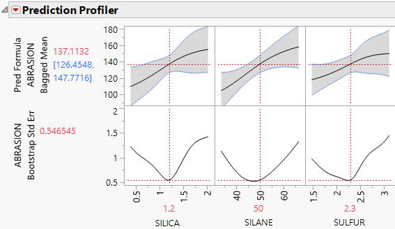

Figure 3.37 Profiler of Bagged Neural Predictions with Confidence Intervals
A profiler is created with confidence intervals using the values from the StdError ABRASION Bagged Mean column.
