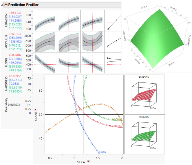

Profiling is an approach to visualizing response surfaces by seeing what would happen if you change just one or two factors at a time. Essentially, a profile is a cross-section view. Use the interactive profilers in JMP to exploring how changes in inputs impact your response(s). In fitting equations to data, the fitting is only the first step. Interpreting the fit, understanding the fitted response surface, and finding factor values to optimize the responses is desirable.
Figure 2.1 Examples of Profilers
