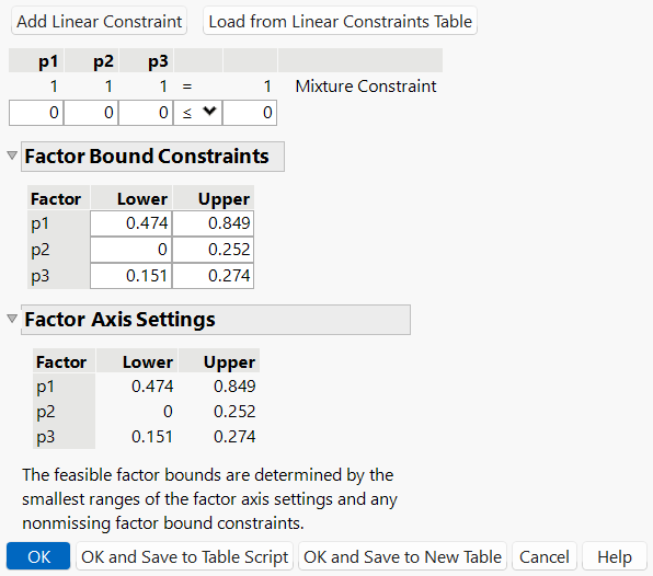

To enter linear constraints via the red triangle menu, select Linear Constraints>Edit Constraints from either the Prediction Profiler or Custom Profiler red triangle menu.
There are options in the Edit Constraints window to add linear constraints manually or load linear constraints from an existing data table. Click the Add Linear Constraint button to enter an equation to specify the constraint. For example, to enter the constraint p1 + 2*p2 0.9, enter the equation as shown in Figure 2.7. Click the Load from Linear Constraints Table button to import linear constraints from an existing constraints data table.
Note: Saving constraints to a data table is an option in Custom and Mixture designs. The table contains columns of constraints with the ConstraintState column property.
As shown, if you are profiling factors from a mixture design, the mixture constraint is present by default and cannot be modified. The Linear Constraints window also enables you to view the bound constraints and axis settings for each continuous factor. The factor bound constraints can be updated.
Figure 2.7 Enter Coefficients
Enter Coefficients
After you click OK, the Profiler updates the profile traces, and the constraint is incorporated into subsequent analyses and optimizations. There are also options to apply the linear constraint changes and save the constraints to either a data table script or a new data table for future use.
If you attempt to add a constraint for which there is no feasible solution, a message is written to the log and the constraint is not added. To delete a constraint, enter zeros for all the coefficients.
Constraints added in one profiler are not accessible by other profilers until saved. For example, if constraints are added under the Prediction Profiler, they are not accessible to the Custom Profiler. To use the constraint, you can either add it under the Custom Profiler red triangle menu, select OK and Save in the Linear Constraints window, or use the Save Linear Constraints command described in the next section.

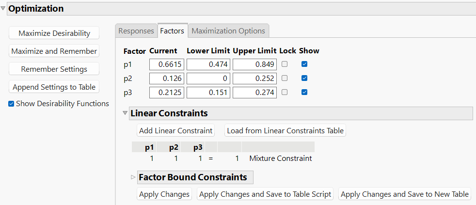

To enter linear constraints via the Optimization control panel, select Optimization and Desirability > Optimization Control Panel and click the Factors tab.
In the Linear Constraints section, there are options to add linear constraints manually or load linear constraints from an existing data table. Click the Add Linear Constraint button to enter constraint coefficients into the appropriate boxes. Click the Load from Linear Constraints Table button to import linear constraints from an existing data table. You can also use the Factor Bound Constraints section to view and change the bounds for each continuous factor.
Figure 2.8 Optimization Control Panel
The Apply Changes option applies the constraint changes to the Profiler. The Apply Changes and Save to Table Script option applies the constraint changes to the Profiler and saves the linear constraints to a table script called Constraint. The Apply Changes and Save to New Table option applies the constraint changes to the Profiler and saves the linear constraints to a new data table.
