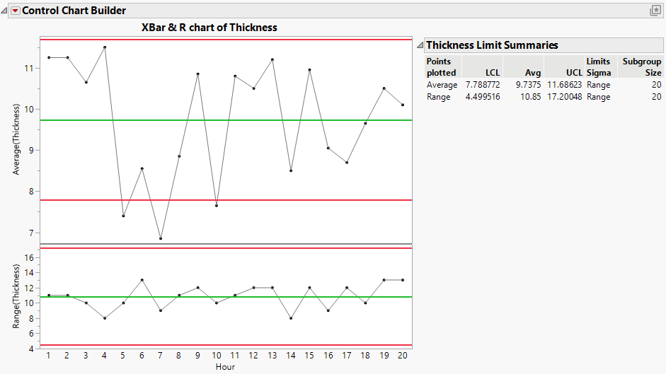

3. Drag Thickness to the Y zone.
4. Drag Hour to the Subgroup zone (at bottom).
Figure 3.2 Control Charts for Socket Thickness
Looking at the Average chart, you can see that there are several points below the lower control limit of 7.788772. You want to see whether another variable might be contributing to the problem.

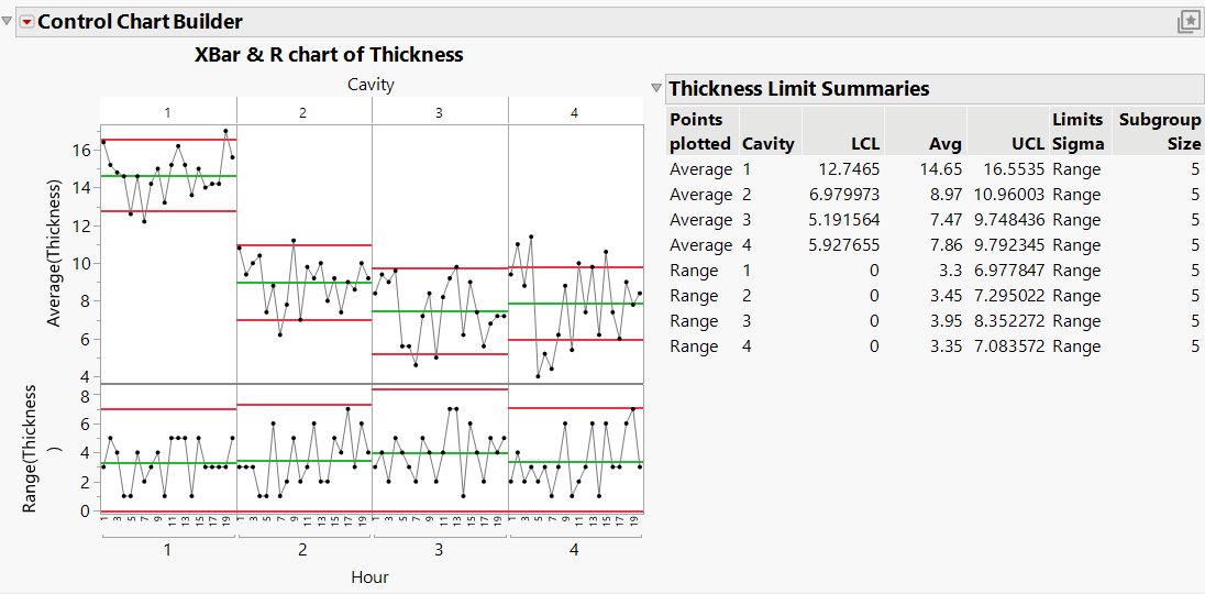

5. Drag Cavity into the Phase zone.
6. Click Done.
Figure 3.3 Control Charts for Each Cavity
From the Average chart, you can make the following conclusions:
There are differences between the cavities, indicating the need for separate control limits for each cavity.
Cavity 1 is producing sockets with an average thickness above that of the other cavities. This indicates that further investigation of the differences between cavities is warranted.
All of the cavities have points that are outside the control limits. Therefore, you should investigate the lack of control in the process for each cavity.
The Range chart for each cavity shows that the within-subgroup measurements are in control and are similar across cavities.
