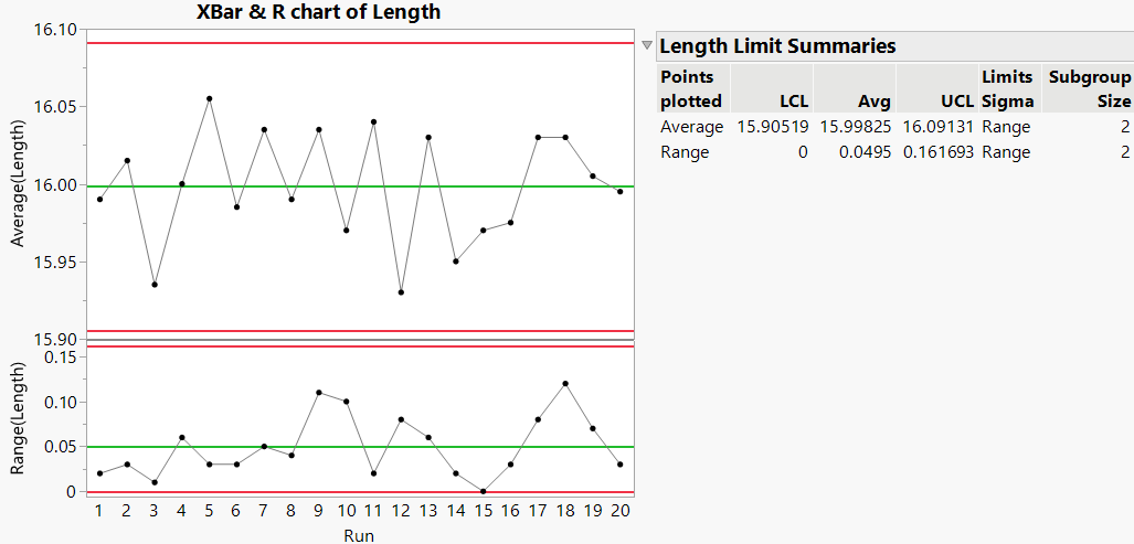

Create the Baseline Control Chart
First, examine whether the existing process is in control. If it is, the calculated control limits can be used as baseline or historical limits.
1. Select Help > Sample Data Folder and open Quality Control/Line Length.jmp.
2. Select Analyze > Quality and Process > Control Chart Builder.
3. Drag Length to the Y zone.
An Individual and Moving Range chart of Length appears. This chart is appropriate if you have no natural subgrouping in your data. However, in this example, there is a natural subgrouping, which is each print run.
4. Drag Run to the Subgroup zone (at bottom).
Figure 3.12 XBar and R Chart of Line Length by Print Run
Three lines are drawn horizontally across the XBar and R charts. These are the calculated LCL (lower control limit), Avg (average) and UCL (upper control limit).
Ideally, all of the points should fall randomly within the control limits The chart shows that no points fall outside of the control limits, and there does not appear to be a pattern to the points. To investigate further, perform Western Electric tests to check for patterns and trends that would cause these tests to fail. (The Western Electric tests are also referred to as Nelson tests.)
5. In the XBar chart, right-click and select Warnings > Tests > All Tests.
Notice that no points were circled or flagged. This means that the process is in control or stable.
If it had been determined that the process was not in control, we would investigate out of control points or work to alter our process so that it is in control. For this example, since the process is already in control or stable, we can skip that step. Now, you can use these control limits with new data. Proceed to Specify Control Limits, or Specify Multiple Sets of Control Limits (to see an example with phase data).

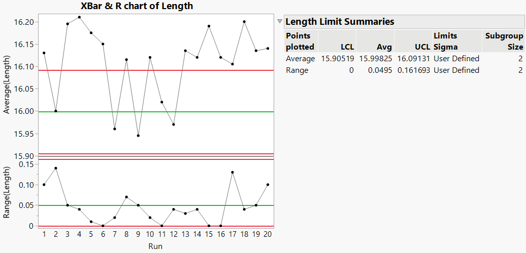

Set Control Limits Option
One simple way to specify control limits is to use the Set Control Limits option in Control Chart Builder.
1. Select Help > Sample Data Folder and open Quality Control/New Length Data.jmp.
This is the table that contains your new data.
5. Right-click in the Average (XBar) chart and select Limits > Set Control Limits.
6. Enter these limits:
LCL - 15.90519
Avg - 15.99825
UCL - 16.09131
These are the historical limits from the Average (XBar) chart in Figure 3.12.
7. Click OK.
8. Right-click in the Range (R) chart and select Limits > Set Control Limits.
9. Enter these limits:
LCL - 0
Avg - 0.0495
UCL - 0.161693
These are the historical limits from the Range (R) chart in Figure 3.12.
10. Click OK.
Figure 3.13 XBar and R Chart of Line Length with Historical Limits
Rather than calculating limits from the data, JMP used the historical control limits that you defined. In the Length Limit Summaries table, notice that the Limits Sigma now says User Defined. Many points now fall outside of the limits. Also, the averages are higher than those of the baseline process. This process appears different from the original process that was used to calculate the baseline control limits.

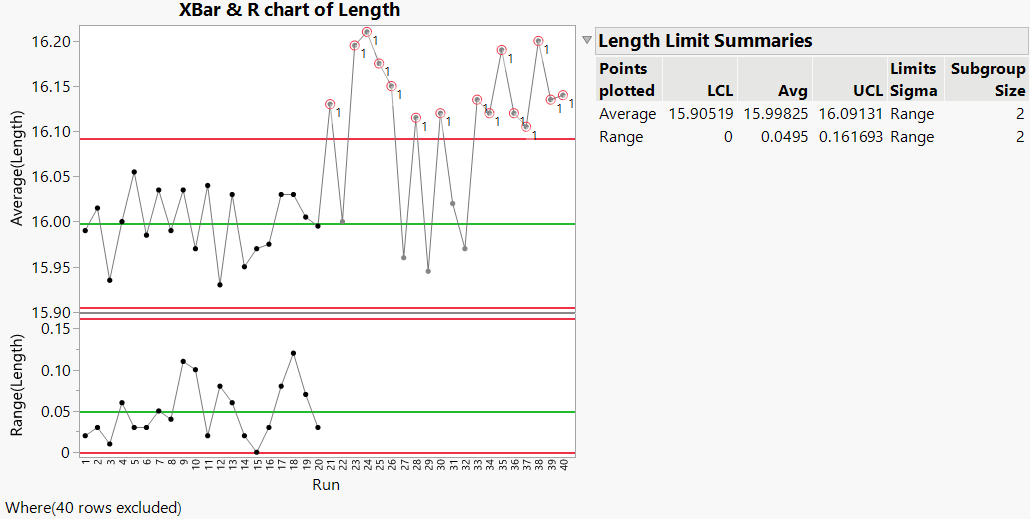

Exclude Rows
Another way to specify control limits is to exclude rows in a data table. One advantage to this method is that you can see both the historical data and new data in the same graph. This can help to visualize and investigate differences when they occur between the data collection periods.
To use this method, you must meet the following criteria:
New and old data must reside in the same data table.
Historical data and new data must all have equal subgroup sizes.
All new data must be excluded in the data table (using Rows > Exclude/Unexclude).
In this example, new data have already been excluded.
1. Select Help > Sample Data Folder and open Quality Control/Combined.jmp.
This table contains old and new data, and the rows corresponding to the new data are excluded.
Figure 3.14 XBar and R Chart of Line Length with Excluded Data
JMP uses only the unexcluded rows (historical data) to create the control limits. The new data (excluded data) are plotted on the graph (dimmed), but these data were not used in any of the calculations. However, when you turn on the tests, all of the data is tested. The new data has many points that fall outside of the control limits and are flagged as failing Test 1 (point is more than 3σ from the average).

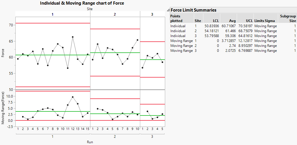

Create a Control Chart Based on Existing Process
1. Select Help > Sample Data Folder and open Quality Control/Phase Historical Data.jmp.
This table contains the existing process data for all three sites.
3. Drag Force to the Y zone.
5. Drag Site to the Phase zone.
Figure 3.15 Baseline Control Chart for Existing Data

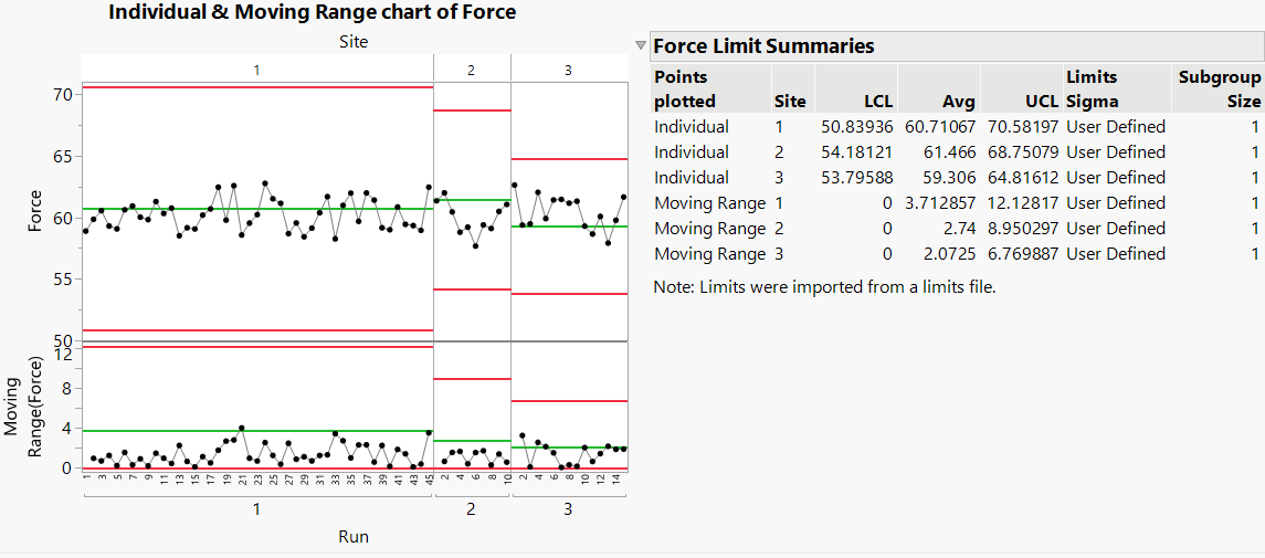

Create a Control Chart Based on Updated Process
1. From the report in Figure 3.15, click the Control Chart Builder red triangle and select Limits > Save Control Limits > in New Table.
This creates a limits table.
2. Save this new limits table to any location, so you can access it later.
3. Select Help > Sample Data Folder and open Quality Control/Phase New Data.jmp.
This data was collected from all three sites after the change was made to the process.
4. Select Analyze > Quality and Process > Control Chart Builder.
5. Drag Force to the Y zone.
6. Drag Run to the Subgroup zone (at bottom).
7. Drag Site to the Phase zone.
8. Click the Control Chart Builder red triangle and select Limits > Get Control Limits. Open the limits table that you saved in step 2.
This applies the historical limits to the new data in the Control Chart Builder report.
Figure 3.16 Control Chart for New Data Based on Historical Limits
Now you can see how the new data (after the process change) compare with the historical process limits (before the process change). None of the points fall outside of the control limits for either the location or dispersion chart. The goal was to reduce variability. Looking at the moving range chart, you can see that most points fall below the average line. For sites 1 and 2, it is clear that the variability of force needed to break the bond between pages and the book spine has been decreased. The decrease at Site 3 is not as strong as at sites 1 and 2. The improvements to the printing process appear to have succeeded in reducing the variability.
