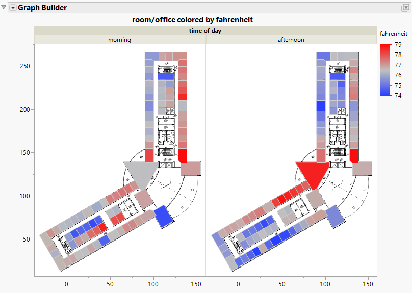

This example demonstrates the creation of a custom background map for an office temperature study and how JMP was used to visualize the results. Data were collected that contained office temperatures for a floor within a building. A map was created for the floor by using the Custom Map Creator add-in from the JMP File Exchange, which you can find at https://community.jmp.com/docs/DOC-6218. The office temperature results were then analyzed visually by using Graph Builder.
Figure 12.36 shows the floor, grouped by time of day. The color reflects the Fahrenheit value. Exploring data visually in this way can give hints as to what factors are affecting office temperature. Looking at this map, it appears that the offices on the east side of the building are warmer in the mornings than they are in the afternoons. On the western side of the building, the opposite appears to be true. From this visualization, you might expect that both of these variables are affecting office temperatures, or perhaps that the interaction between these terms is significant. Such visuals help guide decision-making during the analysis.
Figure 12.36 Room/Office Colored by Fahrenheit and Grouped by Time of Day

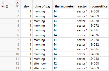

First, data were collected and entered into a data table (S4 Temps.jmp). Note the Room/Office column. This column contains the unique names for each office and was assigned the Map Role to correctly define the map files.
Figure 12.37 Partial View of the S4 Temps.jmp Data Table

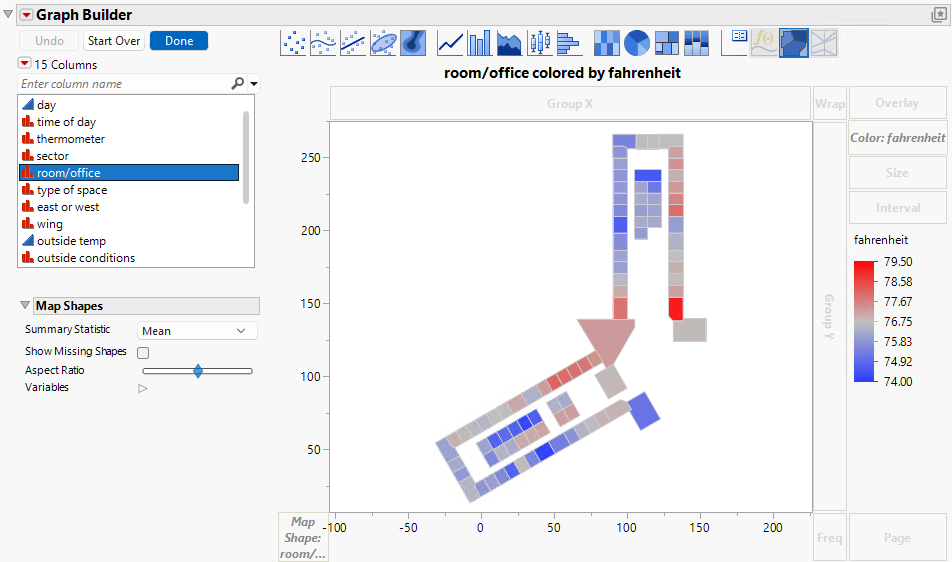

1. Select Graph > Graph Builder.
2. Drag and drop room/office into the Map Shape zone.
Because you defined the Map Role column property on this column, the map appears.
3. Drag and drop fahrenheit to the Color zone.
Figure 12.39 Room/Office Colored by Fahrenheit

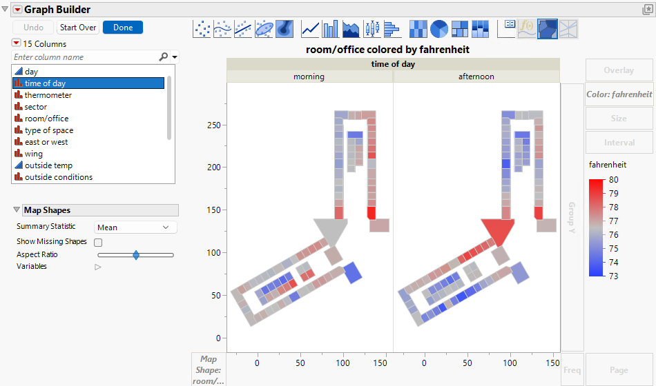

4. Drag and drop time of day onto the Group X zone.
Figure 12.40 Room/Office Colored by Fahrenheit and Grouped by Time of Day
Note that only the offices that were part of the study and were created by using the Custom Map Creator add-in are displayed. To add the entire floor plan image, the original floor plan graphic was dragged and dropped onto the Graph Builder window to create Figure 12.41.
To view Figure 12.41, select Help > Sample Data Folder, open S4 Temps.jmp, and run the by Time of Day script.
Figure 12.41 Room/Office Map with Original Floor Plan
