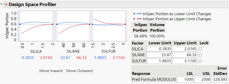

5. Click the Prediction Profiler red triangle and select Design Space Profiler.
6. In the Enter Spec Limits window, specify 1000 as the lower specification limit (LSL) and 2000 as the upper specification limit (USL). These are the specification limits for Modulus.
7. Click OK.
Figure 3.39 Initial Design Space Profiler Report
The initial Design Space Profiler report shows a profiler graph for each factor and several tables. With the factors unconstrained over their full ranges, the InSpec Portion is 58.48%. This means that without defining an operating range, the factors predict responses that fall between 1000 and 2000 about 58% of the time. Now explore setting operating limits on the factors.

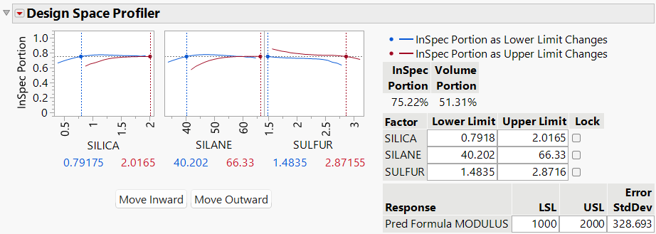

8. Click Move Inward.
The first specification limit to move is the LSL of SILANE.
9. Click Move Inward until the InSpec Portion is above 0.75.
Note: This should take a total of about 11 clicks.
Figure 3.40 Updated Design Space Profiler
The updated Design Space Profiler report shows that setting operating limits improves the InSpec Portion to about 75%. The factor SULFUR keeps a relatively wide range, with only its USL moving slightly inward. The other factors, SILICA and SILANE, keep their USLs at their respective maximums while their LSLs moved inward.

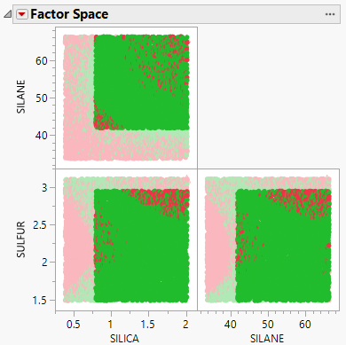

10. Click the Design Space Profiler red triangle and select Make and Connect Random Table.
11. In the Output Random Table window, deselect Add Random Noise.
12. In the Output Random Table window, select Embed Factor Space Scatterplots.
13. Click OK in the Output Random Table window.
The generated data table contains 10,000 rows of uniformly distributed factor settings with their corresponding simulated responses.
Figure 3.41 Scatterplot Matrix Highlighting Desirable Operating Space
The scatterplots provide a visual representation of the operating limits and their impact on the in spec results. Predicted responses that are within the specification limits are colored green and predicted responses that are outside of the specification limits are colored red. The selected points contain factors at values that are within the operating limits. Notice that there are corners of the operating space that have a number of red data points. Continue the example to examine the corners.

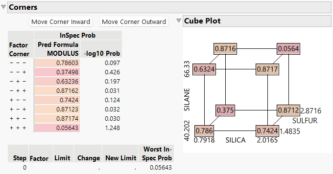

Design Space Profiler Corners
Use the Show Corners option to further evaluate your design space.
1. Click the Design Space Profiler red triangle and select Show Corners.
Figure 3.42 Corners Report
Corners Report
There are four corners of the operating space with InSpec probabilities below our 75% target. In particular, the high SULFUR, high SILICA, and high SILANE corner has an InSpec proportion of only 5.6%. The high SULFUR, low SILICA, and low SILANE corner has a predicted 37.5% InSpec proportion.
2. Click Move Corner Inward.
The first specification limit to move is the USL of SULFUR. The InSpec proportion of the corner improves from 5.6% to 12.6%.
3. Click Move Corner Inward until the predicted InSpec Portion in the corners are all above 0.30.
Note: This should take a total of about 6 clicks.
Review the new limits for operational feasibility.
