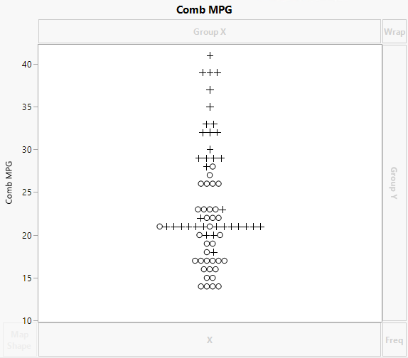

3. Select Comb MPG (combined miles per gallon) and drag it to the Y zone.
Figure 3.4 Initial Graph of Combined MPG
Because markers are assigned to rows in the data table, points are represented by those markers. The value of Comb MPG for each row is plotted at its value on the vertical axis. To avoid over-plotting points that correspond to observations with the same Comb MPG values, JMP automatically jitters the points.

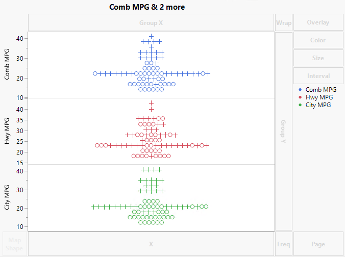

2. Select City MPG, Hwy MPG, and Comb MPG.
3. Hover over the Y zone, press Shift, and click in the Y zone.
This creates separate Y axes for City MPG, Hwy MPG, and Comb MPG.
Figure 3.6 MPG Variables with Separate Y Zone Axes
In the legend at the right side of the graph, markers are colored according to the driving type.

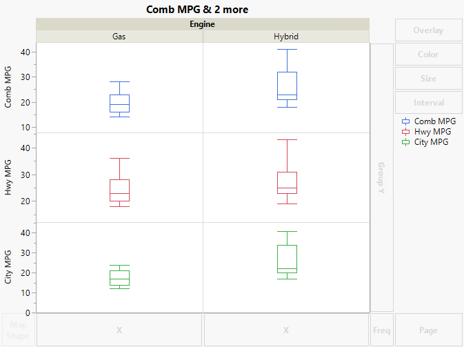

4. Drag Engine to the Group X zone.
5. Click the Box Plot icon Image shown here.
Figure 3.7 Box Plots of MPG Variables by Engine Type
The box plots show the distributions in a very compact form. Notice that all three types of MPG values are substantially lower for the gas vehicles than for the hybrids in the study. From the horizontal lines in the centers of the two City MPG box plots, you can estimate that the median difference is approximately five miles per gallon. However, you can use the Caption element to be sure.

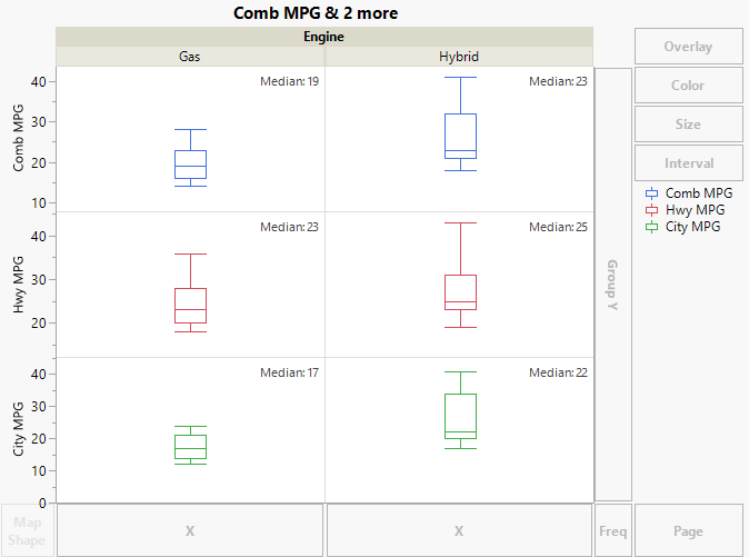

6. Click the Caption Box icon Image shown here.
7. In the Caption Box options at the left side of the plot, select Median from the Summary Statistic list for Comb MPG, Hwy MPG, and City MPG.
Figure 3.8 Box Plots of MPG Variables with Captions
The median city MPG for gas engines is 17 and for hybrid engines is 22.

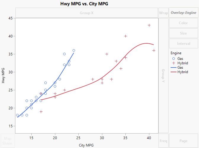

2. Select City MPG and drag it into the X zone.
3. Select Hwy MPG and drag it into the Y zone.
4. Select Engine and drag it into the Overlay zone.
Figure 3.9 Hwy and City MPG by Engine Type
A Smoother appears for each type of engine.

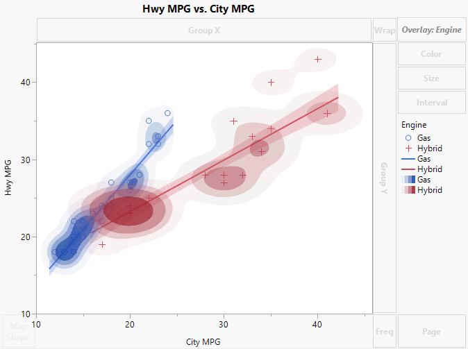

6. Drag a rectangle around the “o” marker with the smallest value of City MPG and check the number of rows that are selected in the Rows panel of the data table.
Notice that two rows are represented by this marker. You can check that overplotting happens for other markers as well. When there is overplotting of observations, namely when several observations are represented by a single point on a plot, density contour plots can help you see the density of points.
7. Drag the Contour icon Image shown here into the graph.
Dragging the Contour icon into the graph retains the Line of Fit for each engine type.
Figure 3.10 Density Contour for Hwy and City MPG by Engine Type
The contours indicate that for both engine types, there are more vehicles in the study with lower MPG values than higher MPG values.
