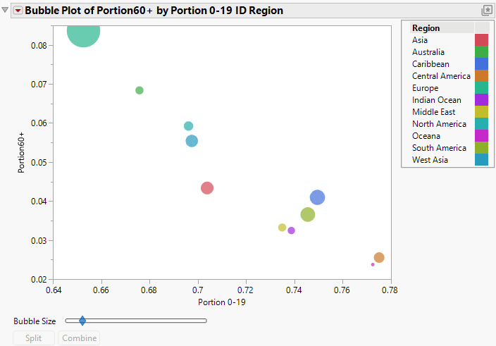

The initial report window appears. (Figure 5.9 uses the default JMP colors.)
Figure 5.9 Initial Report Window with ID VariablesĀ

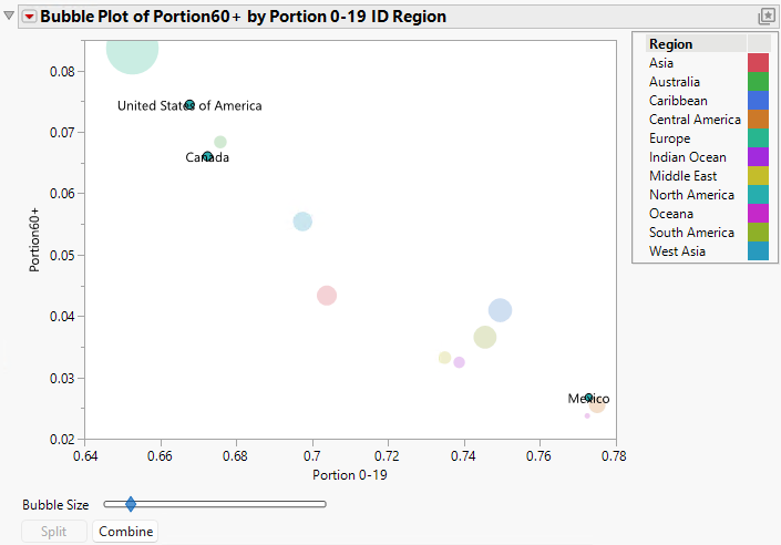

Split the bubble that represents the region of North America into countries.
8. Click the bubble that represents North America (hover over a bubble to see its label, or use the legend to find the color of North America).
9. Click Split.
Notice that the North America bubble has split into three bubbles that represent the countries within the region of North America (the United States of America, Canada, and Mexico).
Figure 5.10 Splitting the North America BubbleĀ
