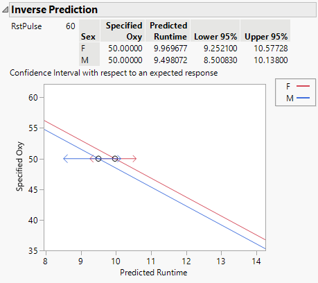

Figure 4.54 Inverse Prediction Report for a Multiple Regression Model
The Inverse Prediction report contains the predicted values of Runtime for both females and males. The plot shows the linear fits for females and males, given that RstPulse is 60. The 95% confidence intervals for females and males are shown in red and blue, respectively.
