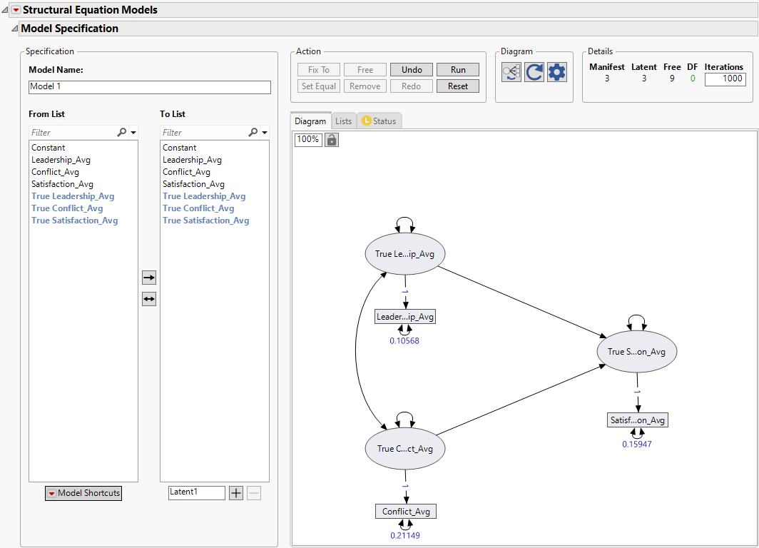

9. Select True Leadership_Avg and True Conflict_Avg in the From List, select True Satisfaction_Avg in the To List, and click the unidirectional arrow Image shown here button.
10. Select True Leadership_Avg in the From List, and True Conflict_Avg in the To List, and click the bidirectional arrow Image shown here button to specify a covariance between the latent variables for Leadership_Avg and Conflict_Avg.
Figure 8.22 Measurement Error Model Specification
11. In the Action section, click Run.

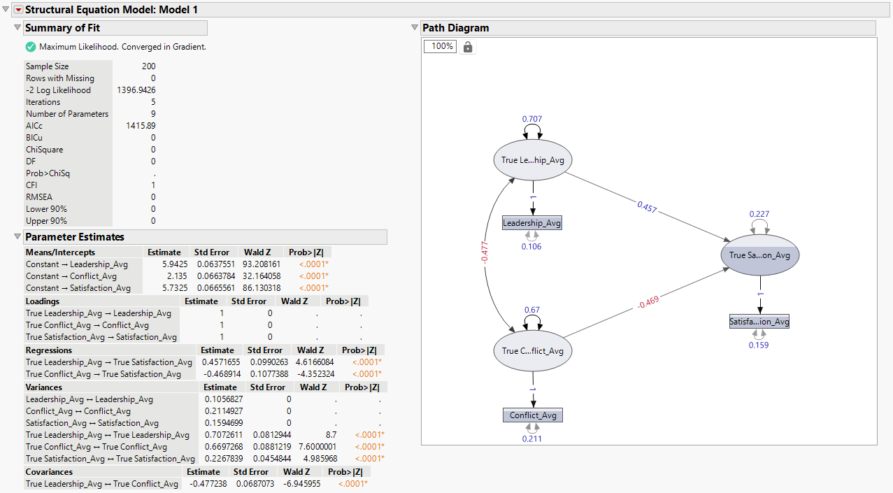

Figure 8.23 Measurement Error Model Report
The Structural Equation Model report includes Summary of Fit and Parameter Estimates tables, as well as a path diagram representation of the fitted model. From the parameter estimates, you can conclude that the model contains significant effects between true dependent and independent variables (p-value < 0.0001). The parameter estimates for True Leadership_Avg and True Conflict_Avg are 0.457 and -0.469, respectively. The standard errors are 0.099 and 0.108 for True Leadership_Avg and True Conflict_Avg, respectively.
The path diagram also highlights the significant direct relationships between True Leadership_Avg and True Satisfaction_Avg, as well as between True Conflict_Avg and True Satisfaction_Avg. The covariance between True Leadership_Avg and True Conflict_Avg is also shown as -0.477. The path diagram also shows estimates of the measurement error variances, converted from the reliability estimates (0.87, 0.76, and 0.82) that were specified in the Account for Measurement Error in Observed Variables window. These numerical equivalents of the estimated variances are shown as 0.106 for Leadership_Avg, 0.211 for Conflict_Avg, and 0.159 for Satisfaction_Avg.
