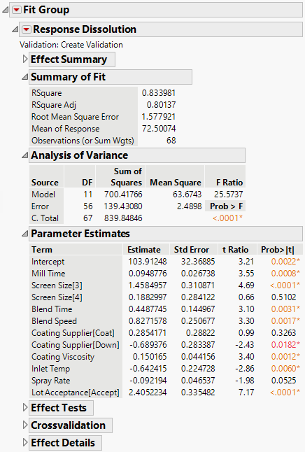

Figure 11.2 Fit Model Report
Fit Model Report
10. To save the prediction formula to a column, click the Response Dissolution red triangle and select Save Columns > Prediction Formula.

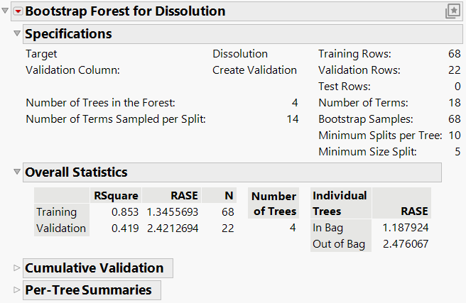

Figure 11.3 Bootstrap Forest Model
8. To save the prediction formula to a column, click the Bootstrap Forest for Dissolution red triangle and select Save Columns > Save Prediction Formula.

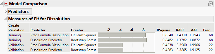

Figure 11.4 Model Comparison Report
The rows in the training set were used to build the models, so the RSquare statistics for Create Validation = Training might be artificially inflated. In this case, the statistics are not representative of the models’ future predictive ability. This is especially true for the bootstrap forest model. Compare the models using the statistics for Create Validation = Validation. In this case, the validation RSquare statistics for the models are almost equivalent (0.434 and 0.438). Both the bootstrap forest model and the regression model have reasonable predictive capabilities.

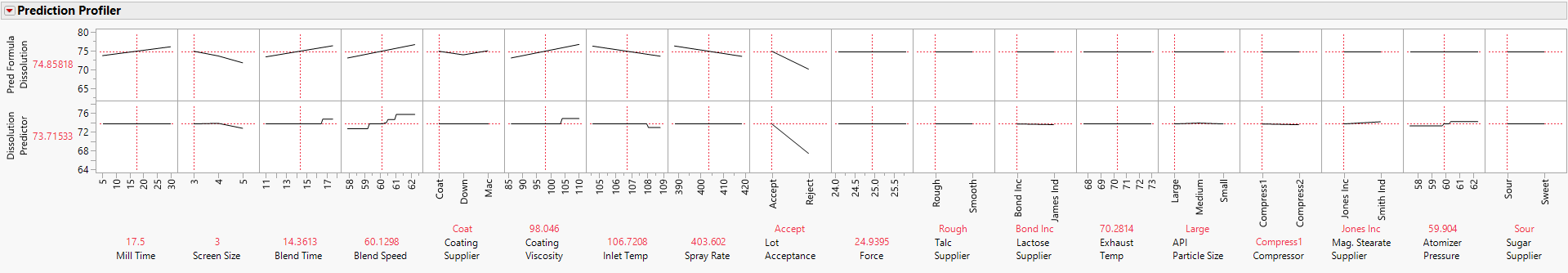

5. Click the Model Comparison red triangle and select Profiler.
Figure 11.5 Prediction Profiler for All Models
The prediction profiler enables you to compare the impact of each factor in the different models. The profiler is especially interesting when comparing different types of models such as here where you have a regression model and a partition model.
