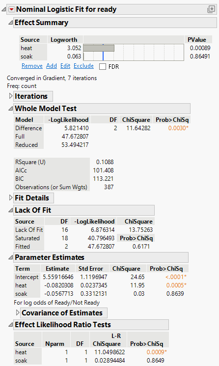

When the fitting process converges, the nominal regression report appears.
Figure 12.2 Nominal Logistic Fit ReportĀ
In the Whole Model Test report, the chi-square statistic (11.64) has a small p-value (0.0030), which indicates that the overall model is significant. However, the parameter estimate for soak has a p-value of 0.8639, which indicates that soaking time is not statistically significant.
