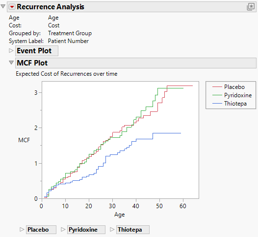

8. Click the gray disclosure icon beside Event Plot.
Figure 11.7 shows the MCF plots for the three treatments.
Figure 11.7 Bladder Cancer MCF Plot
Note that all three of the MCF curves are essentially straight lines. The slopes (rates of recurrence) are therefore constant over time, implying that patients do not seem to get better or worse as the disease progresses.

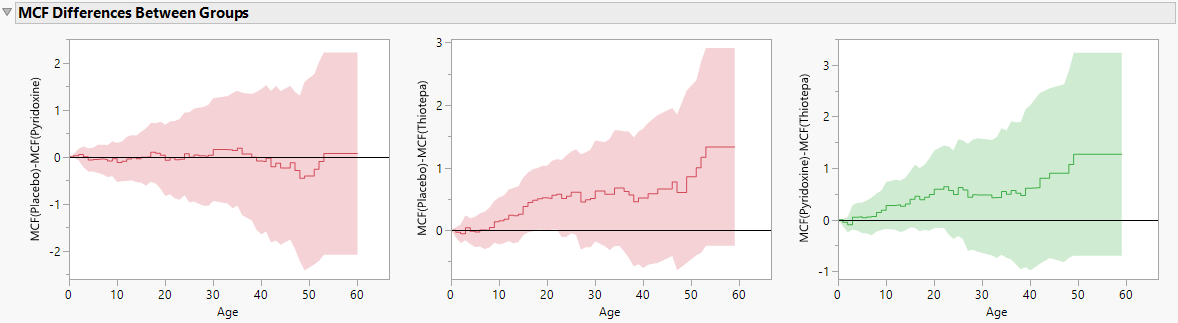

9. To examine if there are differences among the treatments, click the Recurrence Analysis red triangle and select Plot MCF Differences.
Figure 11.8 MCF Differences
MCF Differences
To determine whether there is a statistically significant difference between treatments, examine the confidence limits on the differences plot. If the limits do not include zero, the treatments are convincingly different. The graphs in Figure 11.8 show there is no significant difference among the treatments.
