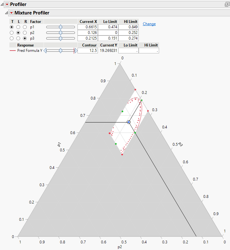

Figure 6.4 Example of Mixture Profiler
Use the factor sliders to explore how changes impact the response. The unshaded region is the feasible region for this data set.
