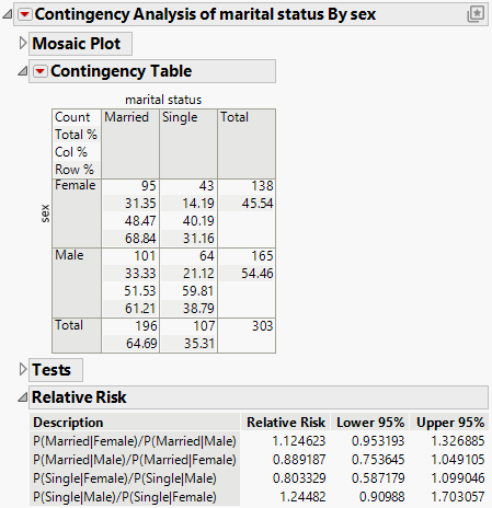

Figure 7.13 Example of the Risk Ratio Report
The relative risk is calculated as follows:
1. Examine the first entry in the Relative Risk report, which is P(Married|Female)/P(Married|Male).
2. You can find these probabilities in the Contingency Table. Since the probabilities are computed based on two levels of sex, which differs across the rows of the table, use the Row% to read the probabilities:
P(Married|Female) = 0.6884
P(Married|Male) = 0.6121
Therefore, the relative risk is calculated as follows:
P(Married|Female)/P(Married|Male) = Equation shown here = 1.124
