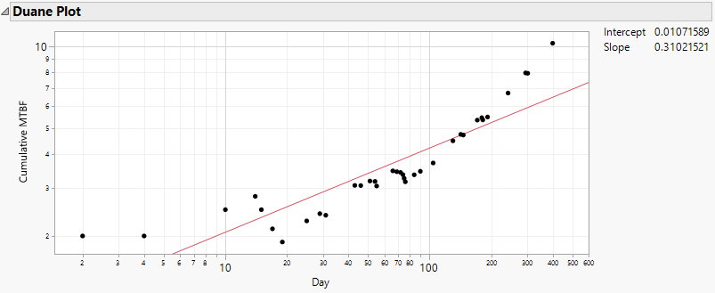

8. Click the Duane Plot disclosure icon.
This provides a plot that displays the Cumulative MTBF estimates on the vertical axis versus the time to event variable on the horizontal axis. If the data follow the Crow-AMSAA model, the points should fall along a line when plotted on log-log paper.
Figure 12.4 Duane Plot
Duane Plot

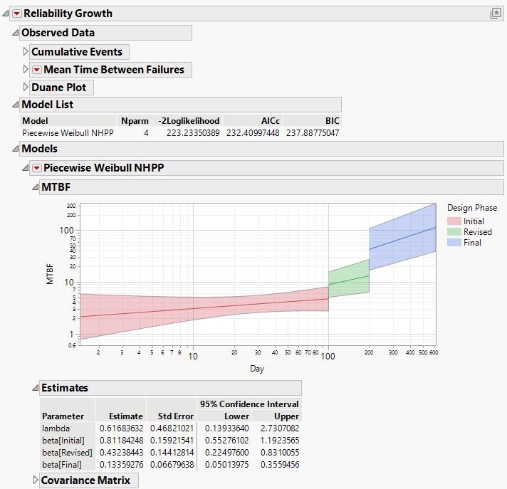

9. Click the Reliability Growth red triangle and select Fit Model > Piecewise Weibull NHPP.
This fits Weibull NHPP models to the three phases of the testing program, treating these phases as multiple stages of a single reliability growth program (Figure 12.5). Options in the Piecewise Weibull NHPP red triangle menu provide various other plots and reports.
Figure 12.5 Piecewise Weibull NHPP Report
