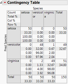

Now you can use the new columns in the data table with other JMP platforms to summarize the discriminant analysis with reports and graphs. For example:
1. From the updated Iris.jmp data table (that contains the new columns) select Analyze > Fit Y by X.
2. Select Species and click Y, Response.
3. Select Pred Species and click X, Factor.
4. Click OK.
The Contingency Table summarizes the discriminant classifications. Three misclassifications are identified.
Figure 10.9 Contingency Table of Predicted and Actual SpeciesĀ
