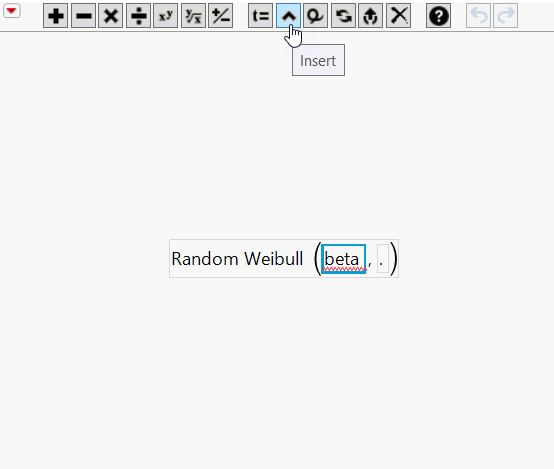

5. In the formula editor, select Random > Random Weibull.
6. The placeholder for beta is selected. Click the insertion element (^).
Figure 9.28 Formula Editor for Simulated Purity Column
This adds a placeholder for the parameter alpha.

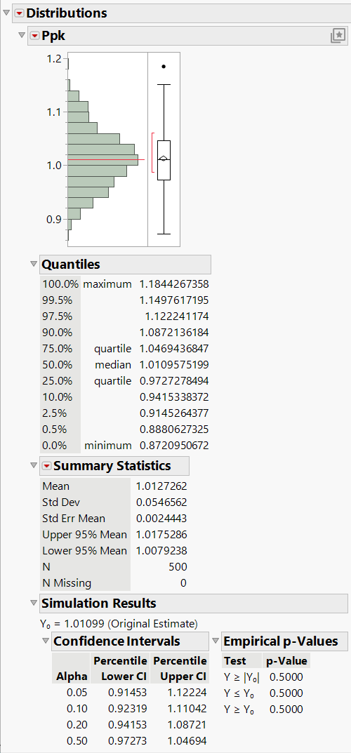

The calculation might take several seconds. A data table entitled Process Capability Simulate Results (Estimate) appears. The Ppk and Ppl columns in this table each contain 500 values calculated based on the Simulated Purity formula. The first row, which is excluded, contains the values for Purity obtained in your original analysis. Because Purity has only a lower specification limit, the Ppk values are identical to the Ppl values.
11. In the Process Capability Simulate Results (Estimate) data table, click the green triangle next to the Distribution script.
Figure 9.30 Distribution of Simulated Ppk Values for Purity
Note: Your values might vary slightly from what is shown, depending on the decimal precision of the parameters in the Simulated Purity column formula.
Two Distribution reports are shown, one for Ppk and one for Ppl. But Purity has only a lower specification limit, so that the Ppk and Ppl values are identical. For this reason, the Distribution reports are identical.
The Simulation Results report shows that a 95% confidence interval for Ppk is 0.915 to 1.122. This indicates that the true Ppk value could be above 1.0, which would place Purity above the Ppk = 1 line in the Capability Index Plot you constructed in Nonnormal Capability Analysis.

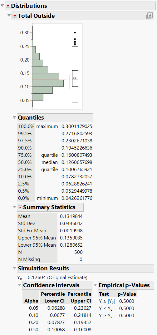

The calculation might take several seconds. A data table entitled Process Capability Simulate Results (Expected Overall %) appears. Because Purity has only a lower specification limit, the Below LSL values are identical to the Total Outside values.
16. In the Process Capability Simulate Results (Expected Overall %) data table, click the green triangle next to the Distribution script.
Figure 9.31 Distribution of Simulated Total Outside Values for Purity
Again, two identical Distribution reports appear. The Simulation Results report shows that a 95% confidence interval for the Expected Overall % nonconforming is 0.063 to 0.230.
