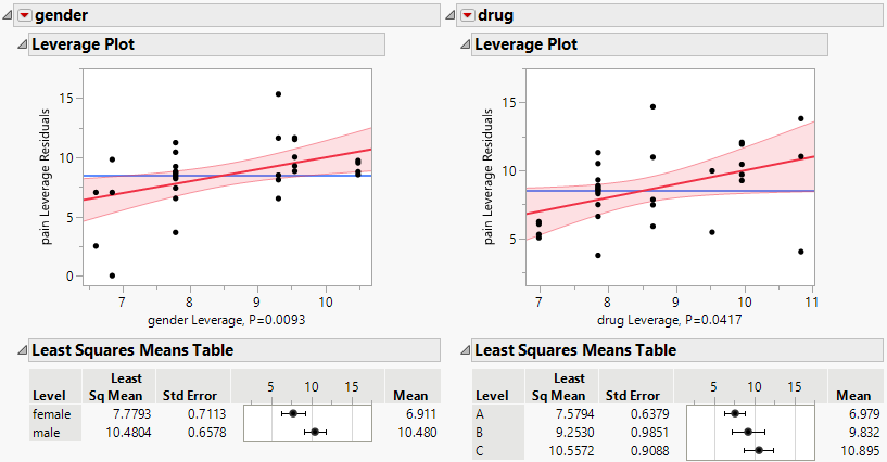

Leverage Plots
Use the leverage plots to identify influential observations and assess their impact on the regression model.
Figure 4.8 Leverage Plot and Least Squares Means Table for Factors
You do not observe any highly influential points. You do observe that both gender and drug have some impact on the response based on the upward trend of the fitted lines and the least squares means values that shift with the levels of gender and drug.

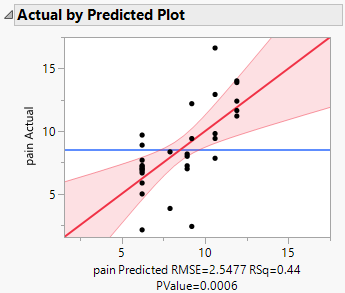

Actual by Predicted Plot
Use the Actual by Predicted Plot to assess the performance and accuracy of the model by comparing the actual values of the pain response with the predicted values from the model.
Figure 4.9 Actual by Predicted Plot
The plot and p-value of 0.0006 indicate that the relationship between the actual and predicted values is statistically significant.

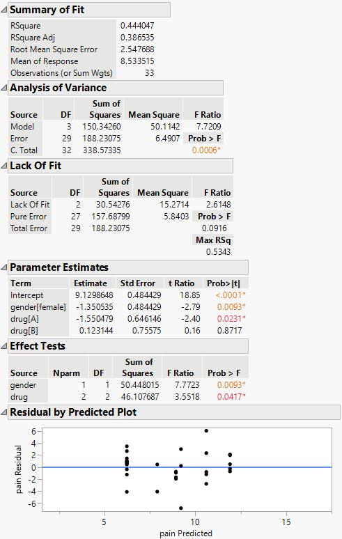

Model Fit Summary Tables and Residual Plot
Use the tables in the report to assess model fit and response variable statistics. The Summary of Fit table contains information to assess model fit and response variable statistics. The Analysis of Variance table contains information about the overall model significance and sources of variation. The Lack of Fit table contains information about model adequacy and error assessment. The Parameter Estimates table contains coefficients, standard errors, and predictor significance. The Effect Tests table contains information about the significance of individual predictors. The Residual by Predicted Plot is to evaluate the assumptions and performance of the regression model by examining the patterns or trends in the residuals across the range of predicted values.
Figure 4.10 Model Summary with ANOVA, Parameters, and Residuals
The tables indicate a regression model with an R-square statistic of 0.444. The effect tests for gender and drug show both factors are statistically significant (with a p-value < 0.05).
