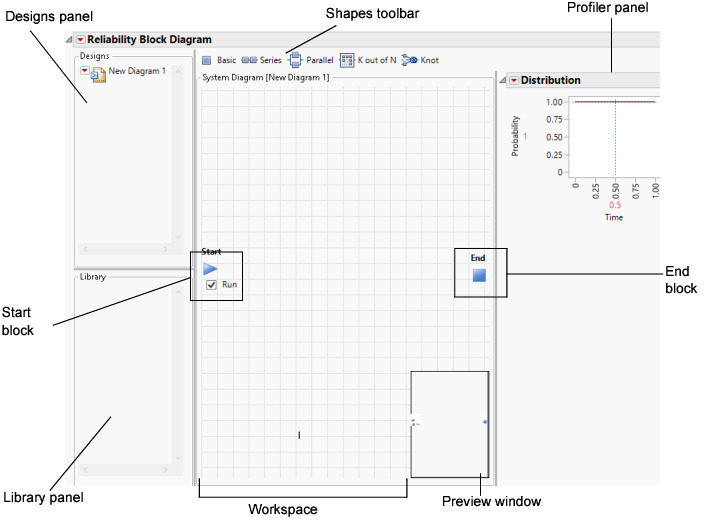

In this example, you learn how to create a new Reliability Block Diagram.
1. Select Analyze > Reliability and Survival > Reliability Block Diagram.
A blank Reliability Block Diagram window appears.
Figure 13.2 New Reliability Block Diagram
Note: The Distribution profiler appears by default.
2. In the Designs panel, select and rename New Diagram 1 to Computer.
The Workspace is now named System Diagram [Computer].
3. Deselect Run in the Start block.
With Run selected, the platform updates the diagram’s reliability calculations after each change to the system diagram. These changes can include adding or deleting components, changing a component’s configuration, and adding or deleting a connection.
With Run deselected, the platform does not update the reliability calculations after any changes.
Tip: Deselect Run when you are diagramming large systems. Select Run when the diagram is complete.
4. Proceed with Add Components.

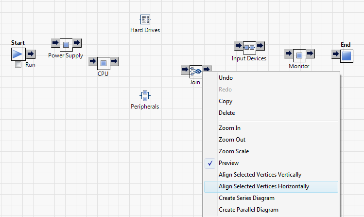

Align Shapes
1. To vertically align the shapes for Hard Drives and Peripherals, select the following components:
Hard Drives
Peripherals
Tip: To select shapes, drag the cursor around the shapes or press Shift and click each shape.
2. With the shapes selected, right-click one of the shapes and select Align Selected Vertices Vertically.
3. To horizontally align the remaining shapes, select the following components:
Start
Power Supply
CPU
Join
Input Devices
Monitor
End
4. With the shapes selected, right-click one of the shapes and select Align Selected Vertices Horizontally.
Figure 13.8 Align Shapes Horizontally
5. Proceed with Connect Shapes.

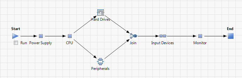

Connect Shapes
To connect shapes, select a shape to display its connection arrows. Suppose you want to connect shape A to shape B. Select shape A. Drag the right arrow to shape B to indicate that shape A precedes shape B. Drag the left arrow to shape B to indicate that shape B precedes shape A. To connect the shapes in your diagram, select the right arrows to connect to the next shape in the sequence.
1. Select the Start block (blue arrow) to display the connection arrow.
2. Select the single connection arrow Image shown here and drag it to the Power Supply component.
Figure 13.9 Connecting Shapes
Connecting Shapes
3. For each of the following components, click the first component, select its right connection arrow, and drag the arrow to the second component:
1. Power Supply CPU
2. CPU Hard Drive
3. CPU Peripherals
4. Hard Drives Join
5. Peripherals Join
6. Join Input Devices
7. Input Devices Monitor
8. Monitor End block
Figure 13.10 Completed System Diagram
4. Proceed with Configure Components.
