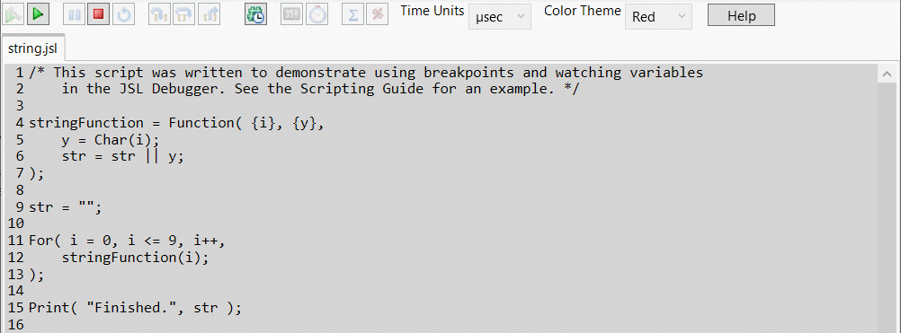

1. Open the string.jsl sample script and click the Debug Script button.
2. Click in the margin for line 12 to add a breakpoint.
You should have a breakpoint for the following expression inside the For() loop:
stringFunction(i);
Figure 4.12 Set the Breakpoint
Set the Breakpoint
3. Click Run.
