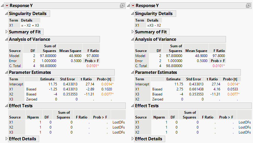

Non-Uniqueness of Estimates
Complete the following steps to see that estimates are not unique when there are linear dependencies:
1. Select Help > Sample Data Folder and open Singularity.jmp.
2. Run the script Model 1. The script opens a Fit Model launch window where the effects are entered in the order X1, X2, X3.
3. Click Run and leave the report window open.
4. Run the script Model 2. The script opens a Fit Model launch window where the effects are entered in the order X1, X3, X2.
5. Click Run and leave the report window open.
Figure 4.55 Fit Least Squares Reports for Model 1 (on left) and Model 2 (on right)
Compare the two reports.
The Singularity Details report at the top of both reports displays the linear dependency, indicating that X1 = X3 - X2.
The Parameter Estimates reports show that the estimate for X1 for Model 1 is –1.25 while for Model 2 it is 2.75.
In both models, only two of the terms associated with effects are estimated, because there are only two model degrees of freedom. See the Analysis of Variance report. The estimates of the two terms that are estimated are labeled Biased while the remaining estimate is set to 0 and labeled Zeroed.
The Effect Tests report shows that no tests are conducted. Each row is labeled LostDFs. The reason is that the effect test for any one of these effects requires it to be entered into the model last. However, the other two effects entirely account for the model sum of squares associated with the two model degrees of freedom. So there are no degrees of freedom or associated sum of squares left for the effect of interest.

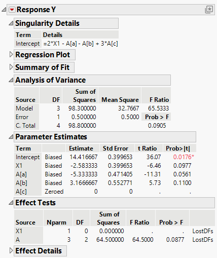

To gain more insight on LostDFs, follow the steps below or run the data table script Fit Model Report:
2. Click Analyze > Fit Model.
3. Select Y and click Y.
4. Select X1 and A and click Add.
5. Set the Emphasis to Minimal Report.
6. Click Run.
Figure 4.56 Partial Fit Least Squares Report for Model with X1 and A
The Singularity Details report shows that there is a linear dependency involving X1 and the three terms associated with the effect A. For more information about how a nominal effect is coded, see “Statistical Details for the Custom Test Example”. The Analysis of Variance report shows that there are three model degrees of freedom. The Parameter Estimates report shows Biased estimates for the three terms X1, A[a], and A[b] and a Zeroed estimate for the fourth, A[c].
The Effect Tests report shows that X1 cannot be tested, because A must be entered first and A accounts for the three model degrees of freedom. However, A can be tested, but with only two degrees of freedom. (X1 must be entered first and it accounts for one of the model degrees of freedom.) The test for A is partial, so it must be interpreted with care.
