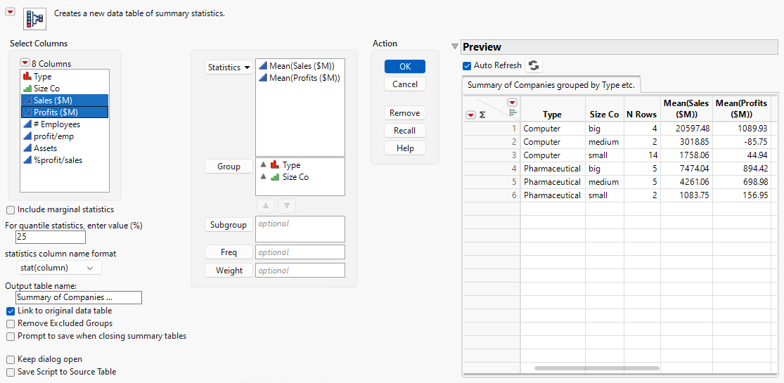

1. Select Help > Sample Data Folder and open Companies.jmp.
2. Select Tables > Summary.
3. Select Type and Size Co and click Group.
4. Select Sales ($M) and Profits ($M) and click Statistics > Mean.
5. Click OK.
Figure 3.18 Completed Summary Window

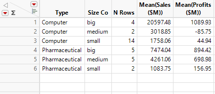

JMP calculates the mean of Sales ($M) and the mean of Profit ($M) for each combination of Type and Size Co.
Figure 3.19 Summary Table
Summary Table
The summary table contains the following areas:
There are columns for each grouping variable (in this example, Type and Size Co).
The N Rows column shows the number of rows from the original table that correspond to each combination of grouping variables. For example, the original data table contains 14 rows that correspond to small computer companies.
There is a column for each summary statistic requested. In this example, there is a column for the mean of Sales ($M) and a column for the mean of Profits ($M).
The summary table is linked to the source table. Selecting a row in the summary table also selects the corresponding rows in the source table.

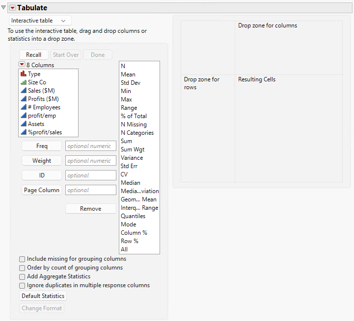

2. Select Analyze > Tabulate.
Figure 3.20 Tabulate Workspace
Tabulate Workspace

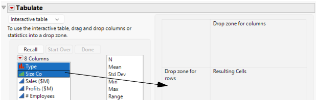

3. Select both Type and Size Co.
4. Drag and drop them into the Drop zone for rows.

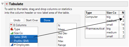

6. Select both Sales ($M) and Profits ($M), and drag and drop them over the N in the table.
Figure 3.23 Adding Sales and Profit
The tabulation now shows the sum of Sales ($M) and the sum of Profits ($M) per group.
