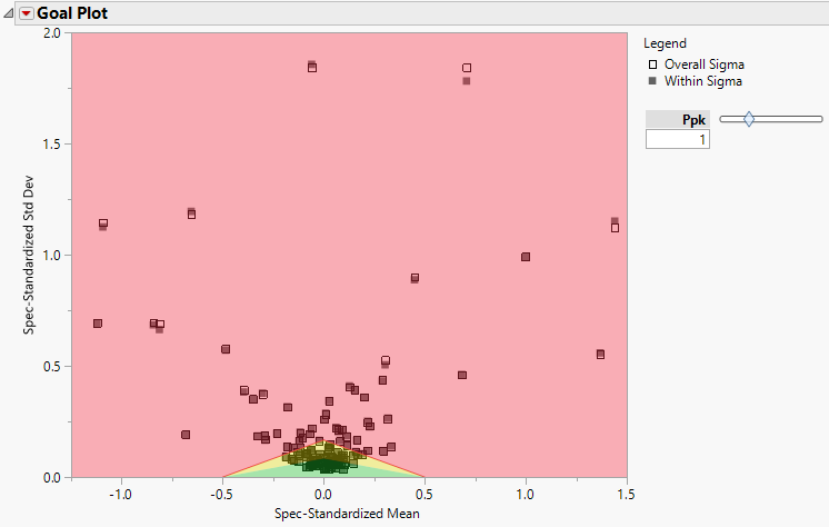

Shade Levels
Shows or hides the Ppk level shading (Figure 9.11). When you select Shade Levels, shaded areas appear in the plot. The shaded areas depend on the relationship between p and Ppk, with p representing the value shown in the box beneath Ppk.
Points in the red area have Ppk < p.
Points in the yellow area have p < Ppk < 2p.
Points in the green area have 2p < Ppk.

Figure 9.11 shows the Goal Plot for the entire data set for the Semiconductor Capability.jmp sample data table after selecting Shade Levels and Show Within Sigma Points from the Goal Plot red triangle menu.
Figure 9.11 Goal Plot
