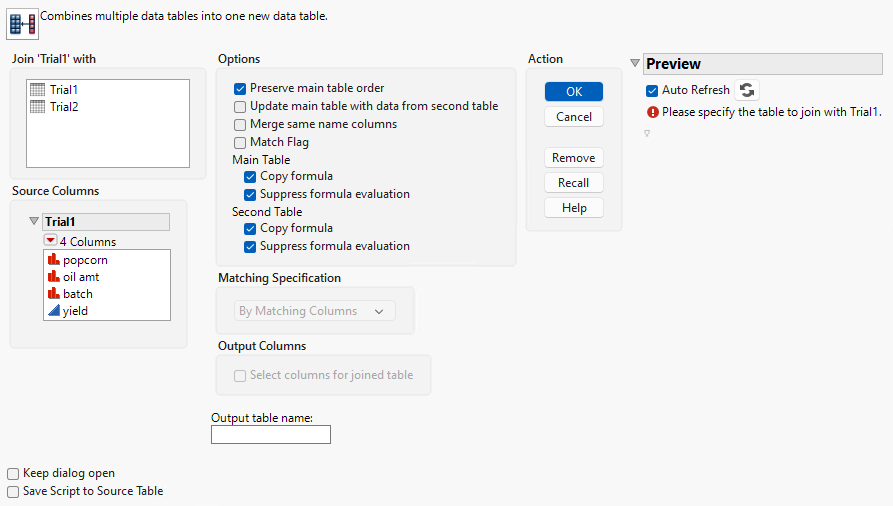

To join two data tables into a new data table, follow these steps:
1. Open the two data tables that you want to join.
2. Select Tables > Join.
In the window that appears, the names of all open tables appear below Join...with.
Figure 6.20 The Join Window
The Join Window
3. In the Join...with box, select the table to join with the active table.
4. From the Matching Specification area, select the option that specifies how to join the tables.
5. Enter the name of the new table in the text box beside Output table name.
6. (Optional) Customize the join procedure further by using the additional options.
7. Click OK to create the joined data table.
Note: Joining on matching columns that have value labels correctly joins with the column’s data values, not the value labels.
