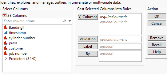

Figure 22.5 Explore Outliers Platform Launch Window
Y, Columns
Specifies the columns that you want to analyze.
Validation
Specifies a validation column that is used for Robust PCA Outliers.
Label
Specifies a column that replaces row numbers in multivariate analysis reports with labels.
By
A column or columns whose levels define separate analyses. For each level of the specified column, the corresponding rows are analyzed using the other variables that you have specified. The results are presented in separate reports. If more than one By variable is assigned, a separate report is produced for each possible combination of the levels of the By variables.
Tip: To run an outlier analysis across all levels of a By variable, press Ctrl and click the desired outlier analysis command button.
