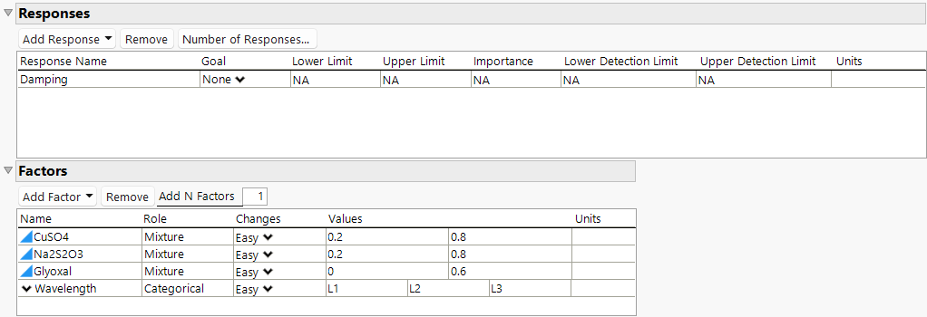

1. Select DOE > Custom Design.
2. Double-click Y under Response Name and type Damping.
3. Click Maximize under Goal and change it to None.
The goal is set to None because the authors of the study do not mention how much damping is desirable.
4. Select Help > Sample Data Folder and open Design Experiment/Donev Mixture Factors.jmp.
5. Click the Custom Design red triangle and select Load Factors.
This loads the three mixture ingredients and the categorical environmental factor. Note that the bounds on the values of the three mixture factors are also loaded.
Figure 5.48 Responses and Factors

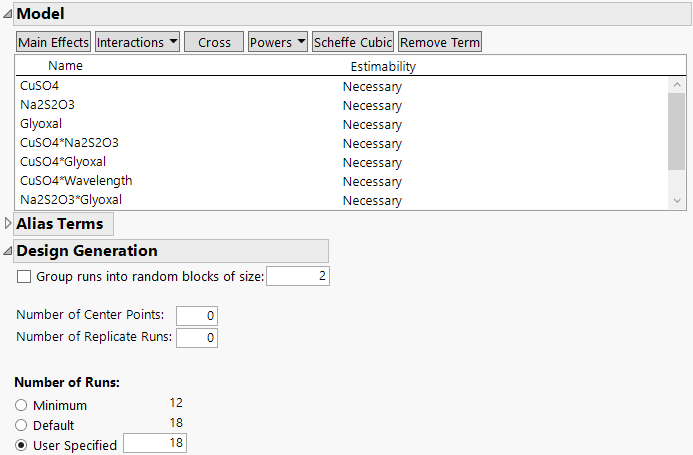

6. In the Model section, click Interactions > 2nd.
An informational JMP Alert window reminds you that JMP removes the main effect terms for non-mixture factors that interact with all the mixture factors. This means that the main effect of Wavelength is removed, but all two-way interactions of mixture factors with Wavelength are added.
7. Click OK to dismiss the message.
The effects in the Model section define a response surface model in the mixture ingredients along with the additive effect of the wavelength. See Scheffé (1958).
Figure 5.49 Model and Design Generation
8. Leave the number of runs at 18.
The choice of 18 runs allows six runs for each of the three levels of the wavelength factor.
