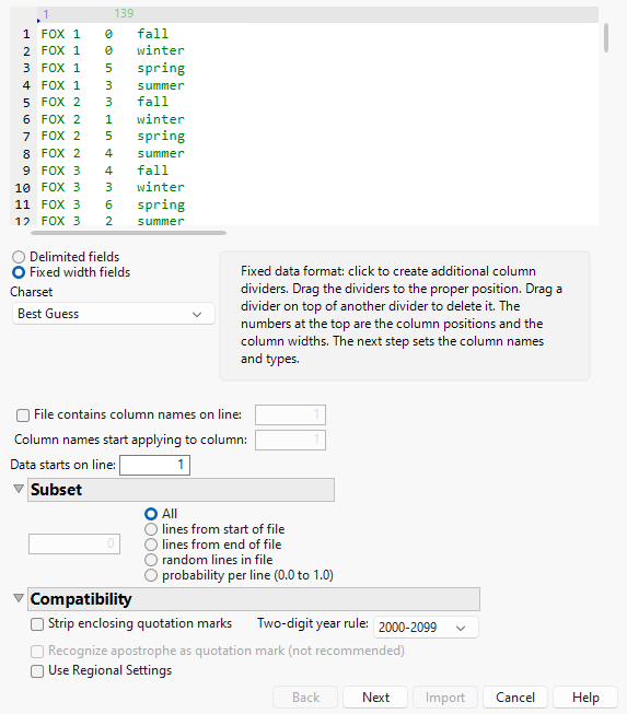

Figure 3.14 Text Import Wizard for Fixed-Width Files

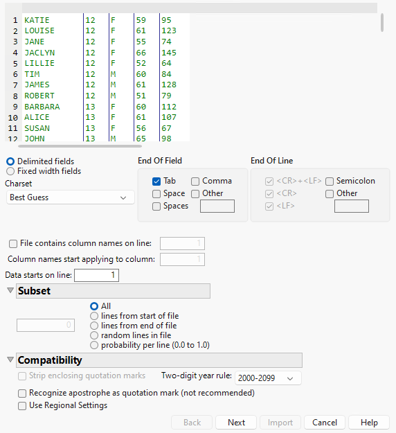

Figure 3.15 Text Import Wizard for Delimited Files
Charset
Select the character set that the imported file uses, or let JMP detect the character set. If the imported file displays incorrect characters, open the file again and select another character set.
End of Field
(Available only in the Delimited Import window.) Select the check boxes beside the character that marks the end of a field. Alternatively, select the check box beside Other and enter a character if the appropriate character is not listed.
End of Line
(Available only in the Delimited Import window.) Select the check boxes beside the character that marks the end of a line (row). Alternatively, select the check box beside Other and enter a character if the appropriate character is not listed. Note that when JMP finds double quotation marks, the delimiter rules change to look for an end double quotation mark. Other text delimiters, including spaces embedded within the quotation marks, are ignored and treated as part of the text string.
File contains column names on line
Tell JMP where to find data to use as column names. For example, if the column names in your text file are on line (row) 3, select this option and type 3 in the check box. Otherwise, JMP uses the data in the first line of the imported file as the column name in the JMP data table or takes the first line as data.
Column names start applying to column
(Available only when the File contains column names on line option is selected.) Specify the number of lines before the column name applies.
Data starts on line
Specify the number of the first line that contains data.
Number of Lines
Specify the number of lines (rows) that you want to import.
Strip enclosing quotation marks
(Available only on fixed-width imports.) Select this check box when you want JMP to remove quotation marks that enclose data in the text file.
Two-digit year rule
Specify how to display dates that have two-digit years. Select the 100-year range in which your dates fall. For example, if the earliest date is 2/2/79, and the year is 1979, select 1970-2069. If the earliest date is 2/2/12, and the year is 2012, select 2000-2099. If dates span centuries, you must recode the dates with four-digit years before you import the data.
Recognize apostrophe as quotation mark (not recommended)
(Available only in the Delimited Import window.) Use this option only if your data comes from a nonstandard source that places apostrophes around data fields rather than quotation marks.
Use Regional Settings
Specifies whether the operating system’s regional settings are used when importing a text file. If the option is deselected (the default setting), files that use a period for a decimal point and a comma for the value separator import correctly. You must specify the value separator in the Text Data Files import preferences.
If the file uses a comma for a decimal point, you must also set the following options: the OS regional settings must use a comma for a decimal point (Windows and Apple macOS), or the Windows Specific Display Language preference must be set to a language that uses commas for decimal points.

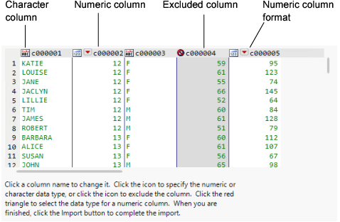

When you are finished selecting the settings, click Next. The next window shows each column’s modeling type. To change the default modeling types, perform one of the following actions:
Click the data type button to change the data type from numeric Image shown here to character Image shown here. Clicking the button cycles between the modeling type and exclude Image shown here. Exclude means that the column is not imported.
To change a numeric column’s data format, select the format from the red triangle menu.
Click the column header to modify the text.
The top of the text import window shows a preview of the text file as it appears when the file is imported into a JMP data file. Click the Import button to import the data.
Figure 3.16 Text Import Wizard Window with Column Options
Note: To specify the format of dates, select the red triangle next to the column name, select Date, and then select the date format. To specify how the dates appear after you import the data, right-click the date column in the data table, select Column Info, and change the date next to Format.
7. When you are finished setting up the data, click Import to complete the text import.
