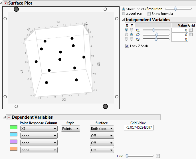

Figure 12.2 Central Composite Design for Three Factors
A Box-Behnken design (Figure 12.3) has only three levels per factor and has no design points at the vertices of the cube defined by the ranges of the factors. This type of design can be useful when you must avoid these points due to engineering considerations. But, the lack of design points at the vertices of the cube means that a Box-Behnken design has higher prediction variance, so less precision, near the vertices compared to a central composite design.
Figure 12.3 Box-Behnken Design for Three Factors
