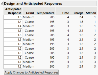

Design and Anticipated Responses
The Design and Anticipated Responses section shows the design preceded by an Anticipated Response column. The Anticipated Response for each design settings is calculated using the Anticipated Coefficients.
An assumed response value for each run in the design. When the section first appears, the calculation of Anticipated Response values is based on the default values in the Anticipated Coefficient column. The assumed values can be updated directly in this table or by updating the Anticipated Coefficients.
Design
The columns to the right of the Anticipated Response column show the factor settings for all runs in the design.
Apply Changes to Anticipated Responses
Applies values from the Anticipated Response column to the Anticipated Coefficients. This also updates the power calculations and the Anticipated RMSE.
Figure 16.8 Anticipated Responses
