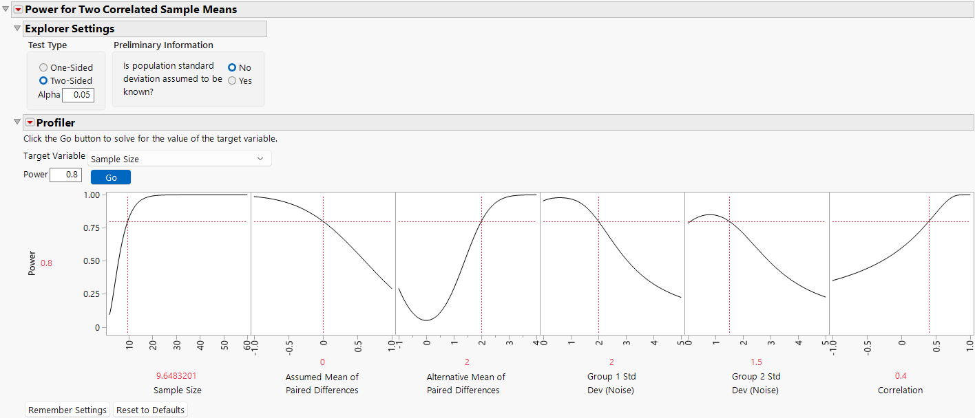

Example of Power Explorer for Two Correlated Sample Means
In this example, use the Power Explorer for Two Correlated Sample Means to estimate the number of subjects to use in an intervention study. You want at least 80% power to test for a difference in paired means of 2. The pre-measurements have an estimated standard deviation of 2 units. However, after treatment, you expect the standard deviation to be only 1.5 units. You are unsure about the correlation between the pre- and post-measurements, so you use a conservative value of 0.4. If the correlation is higher than 0.4, then you have more samples than needed for the specified power. Use a significance level of α = 0.05.
1. Select DOE > Sample Size Explorers > Power > Power for Two Correlated Sample Means.
2. Leave Test Type set to Two-Sided.
3. Leave Alpha set to 0.05.
4. Leave Target Variable set to Sample Size.
5. Leave Power set to 0.8.
6. In the Profiler, set the profilers to the following values:
Assumed Mean of Paired Differences to 0.
Alternative Mean of Paired Differences to 2.
Group 1 Sted Dev (Noise) to 2.
Group 2 Sted Dev (Noise) to 1.5.
Correlation to 0.4.
7. Click Go to solve for the sample size with Power equal to 0.8
Figure 29.7 Two Correlated Mean Explorer
A sample size of 10 (determined by rounding 9.64 up to 10 subjects) enables the detection of a 2 unit difference in pre- and post-intervention results given the standard deviation and correlation assumptions.
