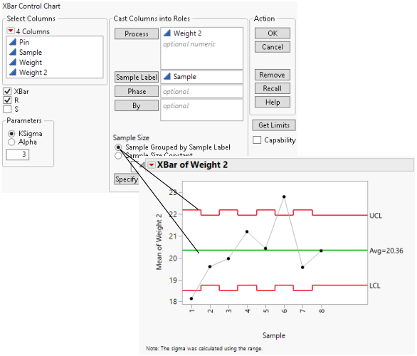

Sample Label
The Sample Label role enables you to specify a variable whose values label the horizontal axis and can also identify unequal subgroup sizes. If you do not specify a sample label variable, the samples are identified by their subgroup sample number.
If the sample subgroups are the same size, select the Sample Size Constant option and enter the size in the text box. If you entered a Sample Label variable, its values are used to label the horizontal axis. The sample size is used in the calculation of the limits regardless of whether the samples have missing values.
If the sample subgroups have an unequal number of rows or have missing values and you have a column identifying each sample, select the Sample Grouped by Sample Label option and enter the sample identifying column as the sample label.
For attribute charts (P, NP, C, and U charts), this variable is the subgroup sample size. Additional options appear on the launch window, including Sample Size, Constant Size, or Unit Size, depending on your selection. In variables charts, it identifies the sample. When the chart type is IR, a Range Span text box appears. The range span specifies the number of consecutive measurements from which the moving ranges are computed.
Notes:
The rows of the data table must be sorted in the order in which the observations were collected. Even if there is a Sample Label variable specified, you still must sort the observations accordingly.
The non-integer part of the value for Constant Size is truncated. If you have a constant non-integer subgroup sample size, you must specify a column of constant values.
The illustration in Figure 13.3 shows an XBar chart for a process with unequal subgroup sample sizes, using the Coating.jmp sample data from the Quality Control sample data folder.
Figure 13.3 Variables Charts with Unequal Subgroup Sample Sizes
