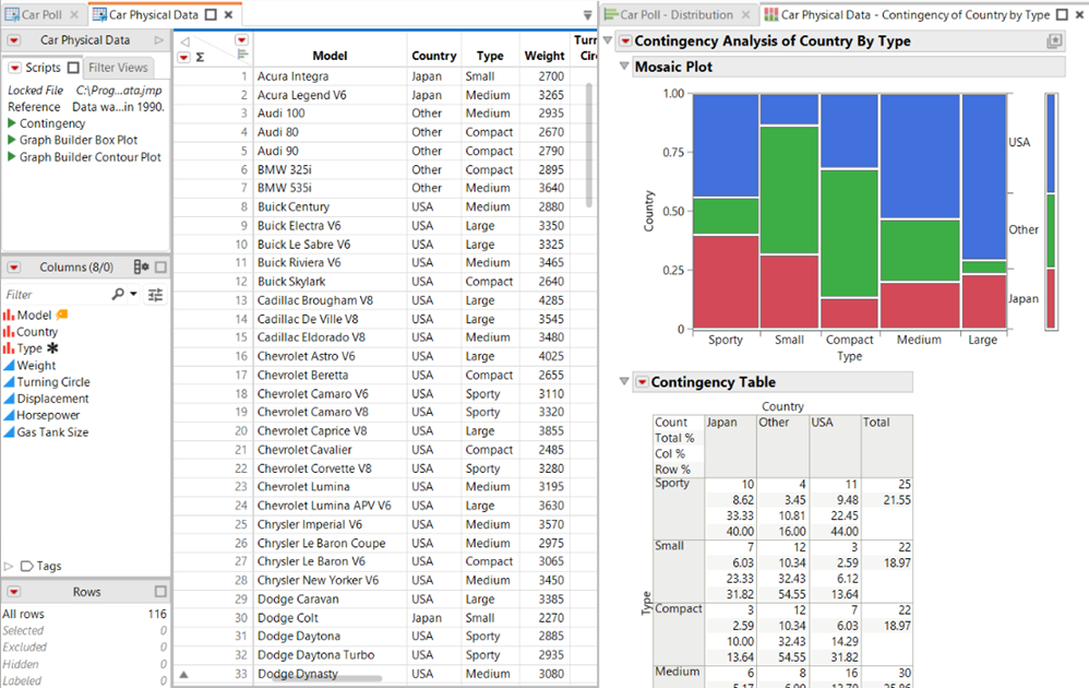

5. Drag the Car Poll - Distribution report tab to the right and drop it into the Dock right zone.
The Distribution report panel appears at the right side of the project window. The report is docked and stays visible when you switch between tabs.
6. Drag the Car Physical Data - Contingency tab to the middle of the Car Poll - Distribution report and drop it into the Dock tab zone.
Tip: You can adjust the size of the data table window to fully show both reports.
7. Click the x to the right of Workspace, Contents, and Recent Files in the left column.
You can show these panels later by selecting the options in the Project menu.
Figure 11.23 Reports and Data Tables Grouped into TabsĀ
The Distribution and Contingency reports are now tabbed together, as are the two data tables.
