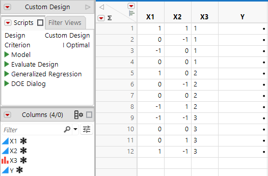

12. Click Make Table.
Figure 5.36 Design Table with Blocking Factor
Because the default Run Order was Randomize within Blocks, the levels of the blocking factor (X3) are sorted.

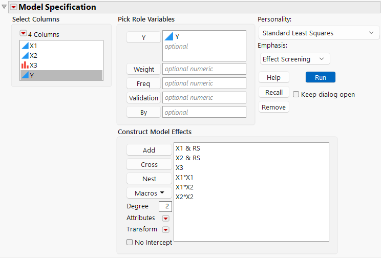

13. In the Table panel of the design table, click the green triangle next to the Model script.
Figure 5.37 Fit Model Window
Fit Model Window
Notice the following attributes of the model effects construction:
The blocking factor (X3) is entered as an effect.
No interactions involving X3 are included.
The other five effects define a response surface model for X1 and X2.
