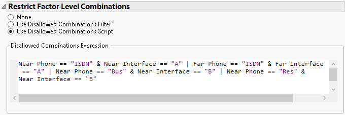

Image shown hereUse Disallowed Combinations Script
This option opens a script window where you insert a script that identifies the combinations that you want to disallow. The script must evaluate as a Boolean expression. When the expression evaluates as true, the specified combination is disallowed.
When creating the expression, use the name of the level in quotation marks. Do not use the ordinal value of the level. For example, Figure 20.8 shows the script that you entered in the phone interface example,Use Disallowed Combinations Script.
Figure 20.8 Script Window That Shows Names of Levels in Quotes
