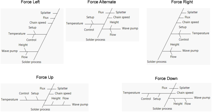

Force Alternate
Draws children on alternate sides of the parent line.
Figure 15.10 Force Options
Force Options
