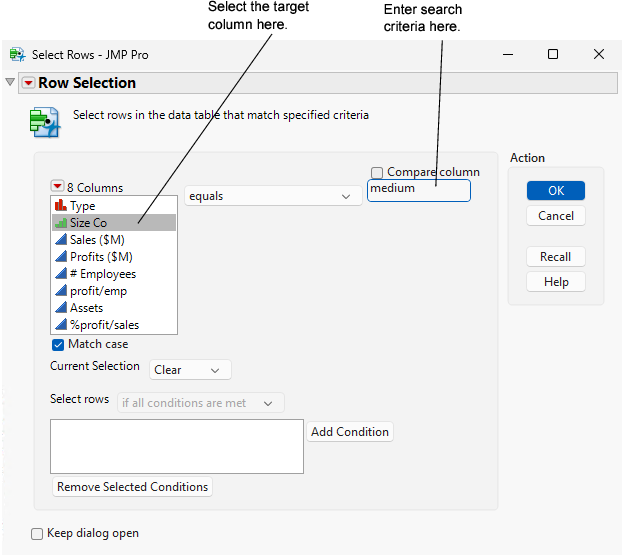

Example of Select All Rows That Correspond to Medium-Sized Companies
1. Select Rows > Row Selection > Select Where to open the Select Rows window.
2. In the column list box on the left side of the window, select Size Co.
3. In the text box on the right side of the window, type medium.
4. Click OK.
Figure 3.10 Select Rows Window
Select Rows Window
JMP selects all of the rows that have Size Co equal to medium. There are seven.
