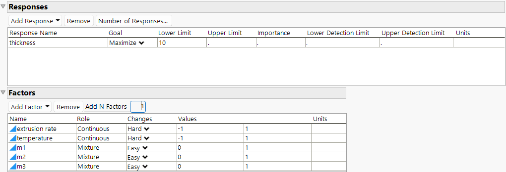

1. Select DOE > Custom Design.
2. Double-click Y under Response Name and type thickness.
Keep the default goal set to Maximize.
3. Enter a Lower Limit of 10.
To add factors manually, follow step 4 through step 11. Or, to load factors from a saved table, select Load Factors from the Custom Design red triangle. Open the Vinyl Factors.jmp sample data table, located in the Design Experiment folder. If you select Load Factors, skip step 4 through step 11.
4. Type 2 next to Add N Factors.
5. Click Add Factor > Continuous.
6. Rename these factors extrusion rate and temperature.
Keep the default Values of –1 and 1 for these two factors.
7. Click Easy and select Hard for both extrusion rate and temperature.
This defines extrusion rate and temperature to be whole plot factors.
8. Type 3 next to Add N Factors.
9. Click Add Factor > Mixture.
10. Rename the three mixture factors m1, m2, and m3.
Keep the default Values of 0 and 1 for those three factors.
Figure 5.68 Responses and Factors
11. Click Continue.

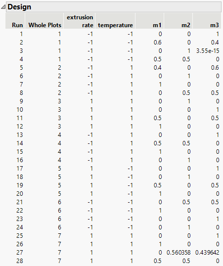

18. Click Make Design.
Figure 5.69 Design
Design
Note that the whole plot factors, extrusion rate and temperature, are reset seven times in accordance with the levels of the factor Whole Plots. Within each level of Whole Plots, the settings for the mixture ingredients, m1, m2, and m3, are assigned at random.

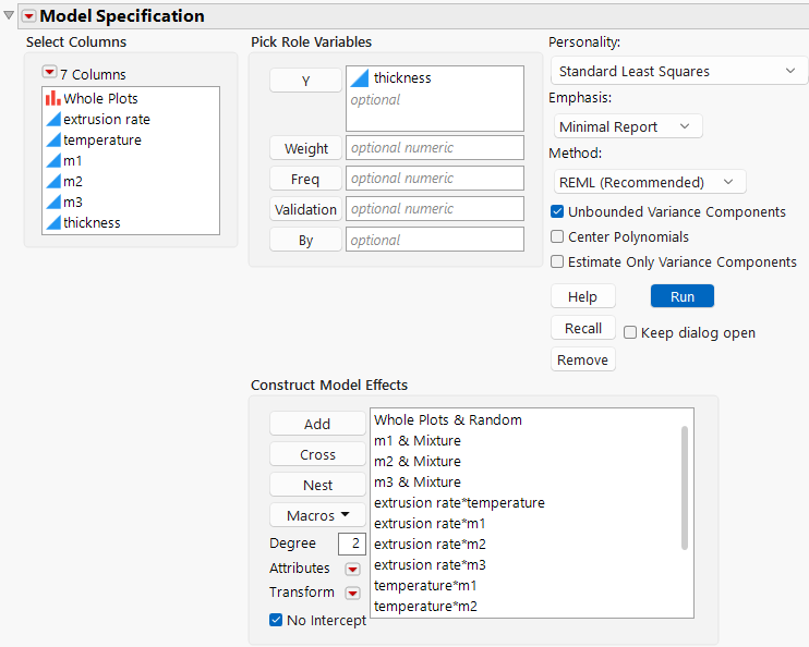

2. In the Table panel, click the green triangle next to the Model script.
Figure 5.70 Fit Model Window
Fit Model Window
Notice the following in the Fit Model window:
The factor Whole Plots has the Attribute called Random Effects (&Random). This specifies that the levels of Whole Plots are random realizations. They have an associated error term.
The analysis method is REML (Recommended). This method is specified precisely because the model contains a random effect. For more information about REML models, see “Restricted Maximum Likelihood (REML) Method” in Fitting Linear Models.
Tip: In the Fit Model window, JMP Pro users can change the Personality to Mixed Model.
3. Click Run.

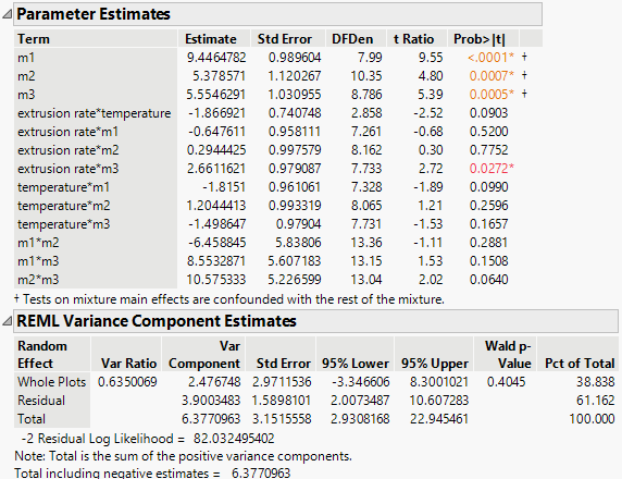

The Parameter Estimates report shows that the three mixture ingredients, as well as the extrusion rate*m3 interaction, are significant at the 0.05 level.
The REML Variance Component Estimates report indicates that the variance component associated with Whole Plots is 2.476748. This is 38.838% of the total variation. It follows that the error term associated with whole plot replication is smaller than the residual (or within-plot) error term.
