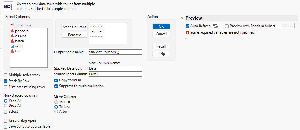

1. Select Tables > Stack.
Figure 6.7 Stack Window
Stack Window
2. Highlight the names of the columns that you want to stack and click Stack Columns.
3. Customize your stacking further by using the additional options.
4. Click OK.
